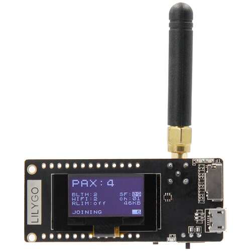

There is this - not sure how easy it will be to driver the 433MHz transmitter from ESPHome, but I’m going to find out shortly.
That one is LoRA. I need 433MHz OOK so I don’t think that would work.
FSK, GFSK, MSK, GMSK, LoRa and OOK modulation
It does, but it’s overkill if you only need $2 ook transmitter. Also the setup is way more complicated.

I haven’t used sx1278, but I immagine the setup being more comparable to cc1101 than dumb ook transmitter.
Sweet thanks, that SX might work after all then! I could make a 3D printed enclosure for it.
