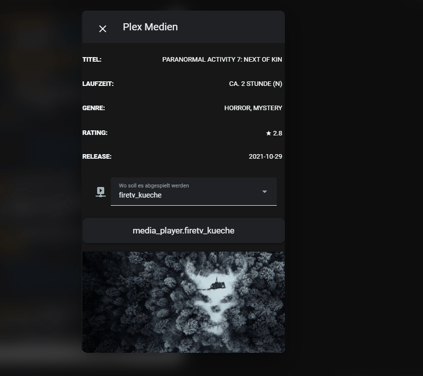

Hi there,
I took a look at part of your code, especially the part with the Plex Media content.
I took parts of your code, e.g. the one for creating the dynamic background images in custom:button-card, I then created a popup on this card, there I select the player that should be used for playback, and then the play button is underneath it.
I tried to do the whole thing with variables in order to get it dynamic and so that it updates the content of the variable for me.
The problem is, however, that if I select eg kitchen for entity_id in my input_select, I first have to close the popup and open it again so that the media_player_play_media accepts the new state of the input_select.
Maybe you have an idea?
my code for the media_player_play_media, here without the variable.

and the variable
variables:
      i: |
          if (entity) {
            let data = entity.attributes.data;
            return data === undefined || Math.floor(Math.random() * (data.length - 1)) + 1;
      test: >-
        [[[ return 'media_player.' +  states['input_select.select_rooms'].state
i made a gif, where you can see that i choose another input_select, the buttons name underneath is the variable. but nothing changes.
popup_novariable change
perhaps you have a idea what i can do?

Thanks for your reply
you speak in the answer of the edit from a fix, I can’t see where a fix should be, or is it just for the special case with the fan?
Only for styles yeah
that’s a real pity then I can delete my concept as it currently is.
how did you solve it by specifying which player you want to use?
does @thomasloven know about it? he is the maintainer of both addons.
