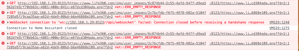

What i get in the console is the following:
What is wrong in my configuration?

Ok, now i can see the entity_picture of my device trackers, but no zone is showed and the error i get in console is the following:
In HAdashboard i get:
