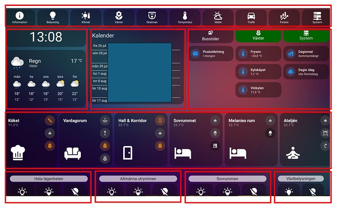

This is fantastic! I hope three layout design featurs are added to sections:
1.A feature to let a section span over several other sections (horizontally) eg to allow for a full width top header menu button bar above other sections:
  1. Resizing sections, eg if I have 3 sections side by side on an iPad, I’d like column 1 & 2 to take up 40% screen width each, and column 3 using 20%.
  2. Make sections reusable over several pages, e.g. defineing a top header menu button section once, and adding it to all my 20 dashboard pages as top menu
What I really want to be able to do is to have different ā€œvertical rowsā€ of sections, where each ā€œsection rowā€ can have a different number of columns horizontally, and each column having its own width (eg 20% or 40% of screen width), to build things like this:

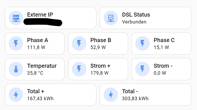

Is there any chance to do the section design like shown in the picture?
First row: 2 cards
Second row: 3 cards
third row: 3 cards
fourth row: 2 cards
all use the full width of the column.
Offcourse! Use 4 horizontal stack cards to do the layout you want!
