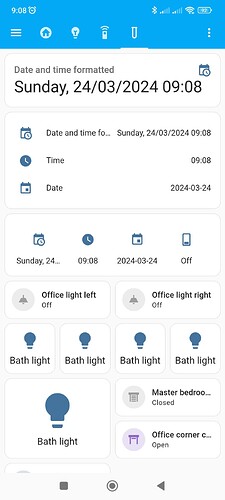

Is there a way for me to combine these two into one? Currently they both take up so much space.
My lighting is heavily automated. If I change the lights manually an automation will likely change them back. This is completely expected. To solve this I have another card to turn off the automation so that the user can take control of the lights.
I would like to be able to designate an automation in one card like this.
Look into using a grid card or custom card like Layout card using their grid system.

Giving this a go as it looks like an efficient way to a great looking dashboard. Two main questions at this point:
  • It looks like a section consists of either 1 width (e.g. weather card), 2 widths (e.g. tile card) or up to 4 widths (e.g. button card). Looking at the mobile screen real estate 3 widths would be ideal; e.g.
    image Is there a way to achieve this with the current implementation?
  • Navigation is done with the top navigation bar at present. If I use the Kiosk add-on I can hide the navigation bar. Is there a way to navigate between views other than the button card for instance?
