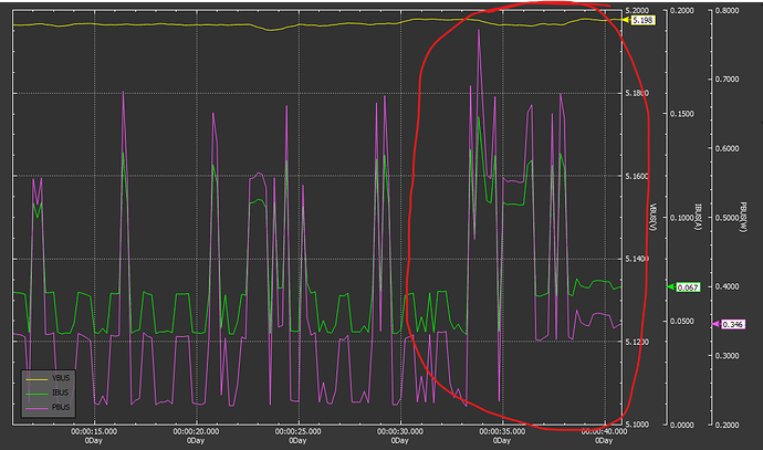

just for reference and interest . I have done current draw tests on the s3 with an inmp441, max98357 operating. These are the results. Yellow=V - purple/pink = W and green = A - the area circled in red is when there was input from the mic and output through the DAC. The board is powered by USB.
other stats were …
