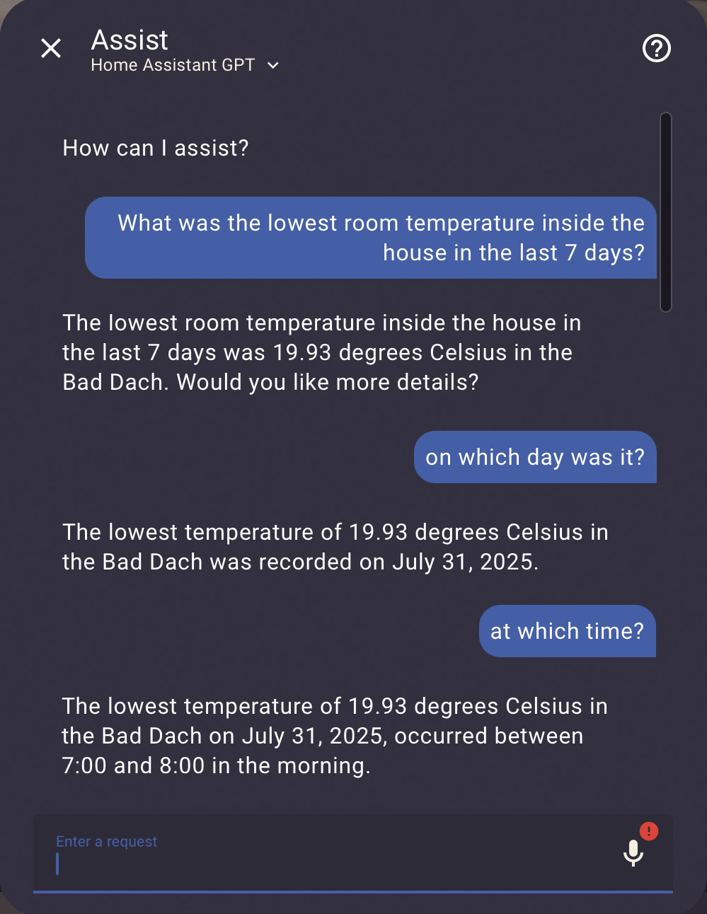

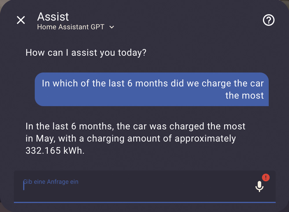

Long Term Aggregated Entitiy History - A script to access historical values (recorder statistics)
Can be used for questions like:
  • How much energy did we export this month?
  • Tell me the min/max temperatures in the garden over the last 30 days.
I noticed that gtp-4o-mini often fails to handle the conversion of time zone.
It likes to provide easier local time strings without timezone to scripts and either forgets about converting the UTC results back to local time (or tells you that there was no matching data in the tool result because it didn’t get the different time zones for input / output).
Giving hints and reminders about that in the tool and in the prompt didn’t help.
gtp-4.1-mini is far better with that.
To keep my Entity History script more usable with gpt-4o-mini, I edited the script to ask for local timezone dates and also to convert returned timestamps to local timezone.
This helps gpt-4o-mini a lot to keep on track.
Here’s the code:

I also added this to my LLMs prompt in addition to exposing this script:
You can also check historical values of an entity using the tool “Entity History”.
But you REALLY need the entity_id of the device to get the historical values.
If you want to check the max temperature from yesterday, outside in the “driveway”, first search for the TemperatureSensor in this area using the “Entity Index” tool.
Hints:
  • Energy (kWh) sensors are cumulative, monotonic increasing counter.
    NEVER reply with their current state when asked about the energy used/produced in a specific timespan.
    Use the “Entitiy History” tool with the aggregation type “change” to get the deviation between start-time and end-time
History is really one of this things that makes Assist so much more useful compared to dumb Alexa. :relieved:
I don’t think I would have been faster looking this up manually on my phone or laptop. :slight_smile:
