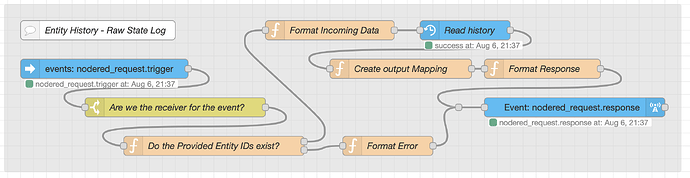

As I use Node-RED for all my automations anyway, the setup looks like this:
  • The “tool” (HA script for the LLM) calls a generic script I posted here to send data to a Node-RED flow and wait for the returned data
  • This generic script sends an event to Node-RED and waits for a response with a different event.
  • Node-RED processes the parameters it received, calls the history API and sends the answer with the event type that the script is waiting for.
  • The generic script hands the answer back to the LLM script
This allows questions about a lot history states that aren’t in the aggregated statistics we accessed in the other history script.

  • Import this Node-Red flow, which does the real work by collecting the history data and calculating the durations and counts for the single states:
