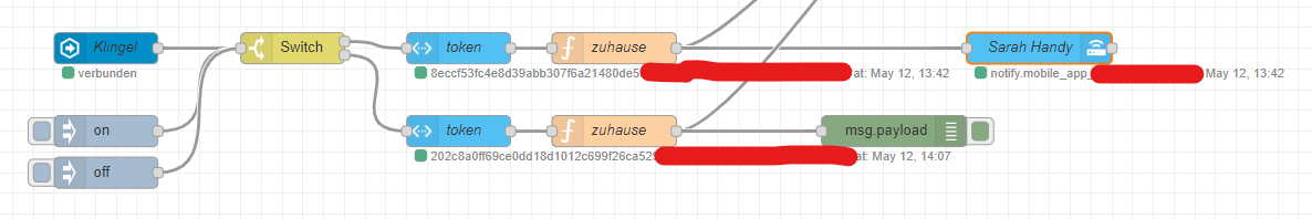

open node red:
  1. event: sate node (tigger)
  2. switch (do sort between different values ( on/off , im my case)
  3. current state node: Entity ID: sensor.cam_token, State Location is set to msg.token
  4. function node:
msg.payload =
   "data": {
      "title": "Haustür",
      "message": "Jemand hat geklingelt",
      "data": {
         "image": "http://XXXX.duckdns.org:8123/api/camera_proxy/camera.garten?token="+msg.token
return msg;
  1. call service node: Domain: notify, Service: mobile_app_my_phone
That’s it, it works perfect.
