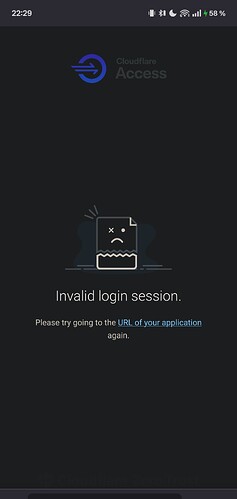

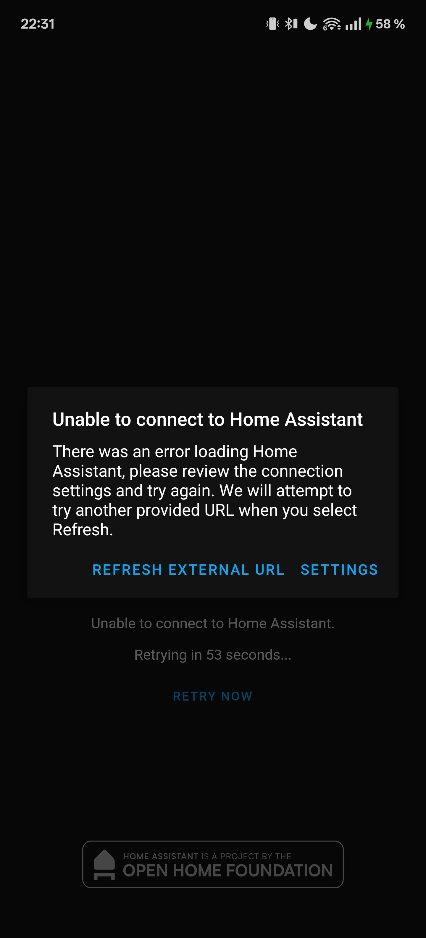

I managed to set up a Cloudflared tunnel so that I could connect remotly to my HA instance. I simply added the domain in as the server in the HA app and logged in and it worked for about a month until today. The app showed me cloudflares site to verify my account with my email which I did but now it fails like this;
However I can still access the tunnel just fine from a web browser.

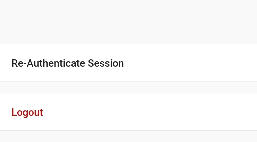

I have had that issue a few times and re-authenticating within the app has always worked.

Last month, I got an idea to just put in the cloudflared domain directly as a server in HA app so that the app always works regardless of the network. I was asked for the pin and it all worked perfectly! But now, my session 30 day limit has expired. I was asked for a pin as usual but then the errors appeared.

The HA Android app does not appear to support token auth (used by the Cloudflare tunnel) at this time. When auth is turned on, the HA app will open a browser, but after sign in the token never makes it back to the app. This is why auth works in a browser, but not in the app. We can however use mTLS to get around this.
I guess setting up the cert is the next step.
Using cert seems to be the way, works for me at least!
