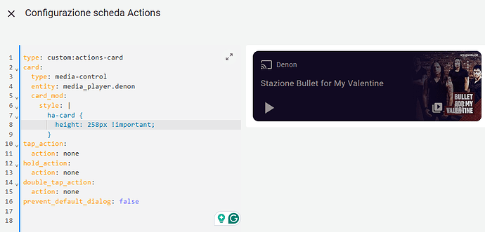

Is there a way to use card-mod to change the card height?
Like this card-mod works without action card
type: custom:actions-card
card:
  type: media-control
  entity: media_player.denon
  card_mod:
    style: |
      ha-card {
      height: 258px !important;
tap_action:
  action: none
hold_action:
  action: none
double_tap_action:
  action: navigate
  navigation_path: /lovelace/media-player
prevent_default_dialog: false
Your configuration is actually correct! The way you’re applying card_mod to the wrapped card is the proper approach with actions-card. The actions-card wrapper is designed to adapt to its content.
thanks for the answer.
could you try my code? because it does not work for me and I would like to understand if I am doing something wrong.
thanks

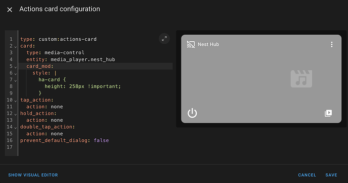

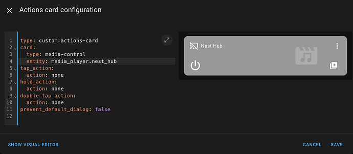

I tried your code and it works fine on my end…
Without the card_mod:
With the card_mod:
i don’t understand…
The same code is not working for me.
I’m on the latest home assistant OS version 2025.8.1 and in all other situations card mod works.
I’ve also tried with a light card but the result is the same.
Is it a standalone card or is it nested inside something else?
@firstcolle , I just released v1.4.2 of the Actions Card in which I added a fix for your issue. It will not re-scan for card-mod styling applied to child cards after the child cards are created. Hopefully this will fix your issue.
If it does not, please open a Bug report on the GitHub page so we can continue our conversation regarding this issue.
@WallyR ; it’s a wrapper card. So basically it will nest another card and add some features such as tap, hold and double-tap action to the wrapped card.
I tried the new version and the problem is not solved. I’ll open an issue on gitub.
