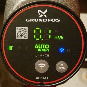

The latest Grundfos Alpha 3 pumps have built in BLE
Would be nice if we could read the sensors and maybe control the pump settings

Alpha 3 Model B
