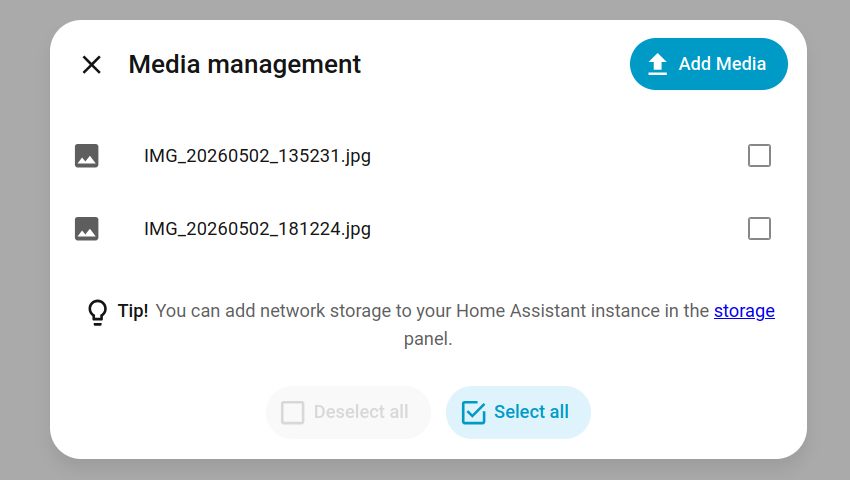

Add Media Button onto dashboard?
I’d like to put this “Add Media” button onto my dashboard - using to to upload photos for Wallpanel, but want to make it easier for my wife
Is there any way I can do this?

I want my wife to easily be able to upload photos to the home assistant media folder from the (or a) app, without having to navigate the media folders
An alternative would be to have it available in the share menu on android, but figured the above is easier!
