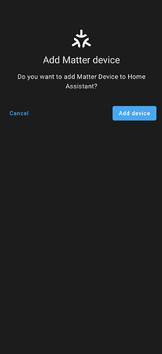

I’m trying to add my first Matter device to HA (container)
  1. I reset the device to factory settings
  2. I scan the QR-code
  3. I choose the Home Assistant app
  4. I press “I’m ready”
  5. I don’t know what the device is connected to: the Tado Bridge X or the smartphone?
    I press “Done”
  6. I press “Add device”
This also happened with other devices.
Does anyone have any idea what could be going wrong?
