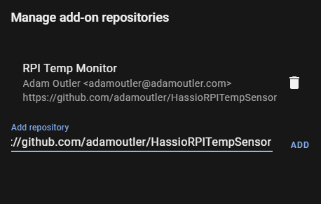

I made an addon which creates a CPU Temperature sensor for Raspberry Pi.
Here it is in action.
Install:
Supervisor -> Add-on Store-> … -> Repositories
add https://github.com/adamoutler/HassioRPITempSensor
Then install and start the Addon
