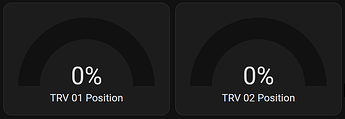

it would be nice to control the degrees of opening directly - until now i believed that this is up to the internal logic of the TRVs and that there is no way of controlling the valves directly. Havent tried it yet …
Is this true? or can we control the valves directly?
My Tuya TS0601 seems to know at least 25% 50% 100% (i have created gauge cards on the dashboard for the valve states to really see, what the TRVs are doing physically)
so yours should too?
