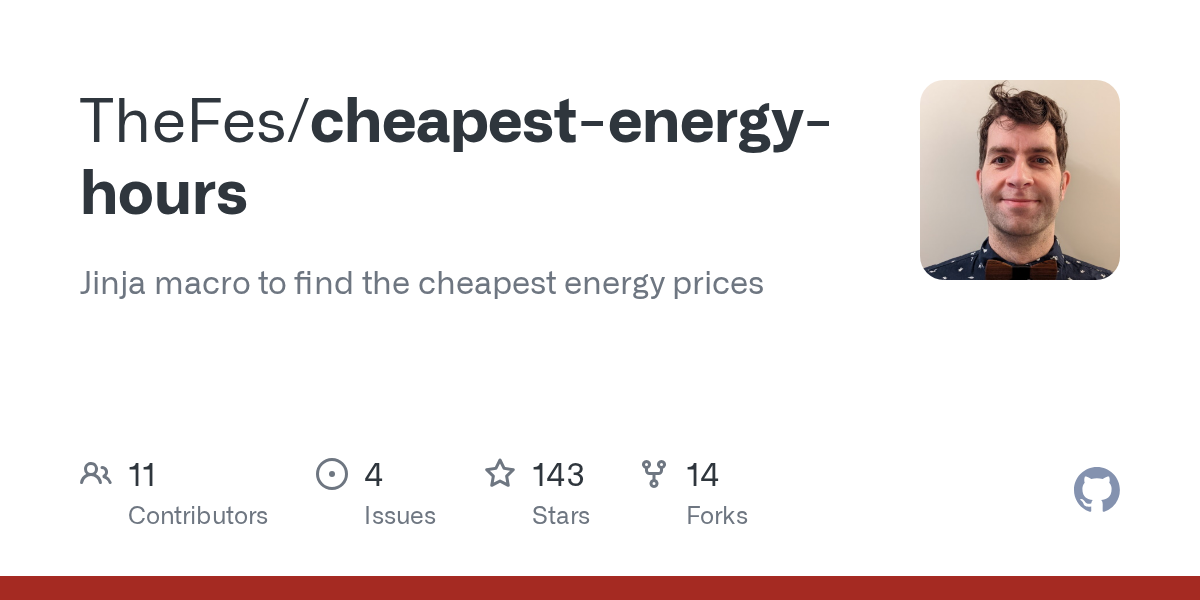

I think you want this macro, which was written by @TheFes and is well documented. There are examples in the documentation as well.
Many thanks for the recommendation! That macro seems to do exactly what want.
