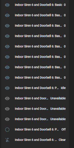

@adamoutler… Hi, I’m sorry again, I followed the manual step-by-step, but nothing happens … Still a fun hobby, but I hope to get a little further now. Does anyone have an idea what I’m doing wrong here?
Try some different entities. You’re filtering them and using the wrong one. Don’t filter and find the one that looks like in my pic.

The doorbell is showing up in the zwavejs2mqtt control panel but has very few values and the ones it does have don’t have any useful functionality as a doorbell.
Define 'working '. Show up with config and sound switch board. Using the ringing endpoints from ha is not ready yet
It doesn’t generate any zwave_js_events in HA when I press either doorbell button.
And none of the battery entities (which I assume are supposed to be the doorbell button themselves) are showing any values. All show 0%
and none of the automatically configured entities in HA change states when I push either doorbell button.
