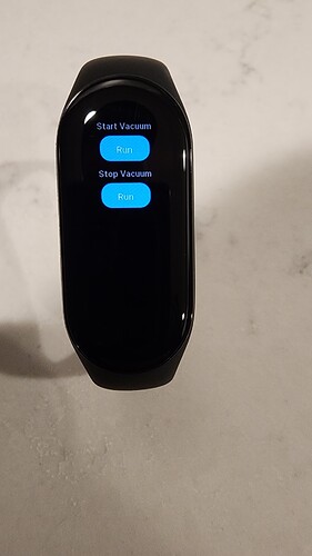

ZeppOS app that uses the Home Assistant REST API to control entities and updates the wearable sensors to Home Assistant including:
- Daily Heart Rate values
- Recent Sleep data
- Battery %
- PAI values
- Daily Steps
- Daily Calories burnt
- Daily Standing hours
- Wear status
A few months ago, I “upgraded” my wearable device from an old, slow and expensive Fossil smart watch to a €35,- smart band (Xiaomi Mi Band 7). The main features that I require from my wearable is that it can control my Home Assistant entities, and keep track of my health / fitness (and of course display the time).
I became aware of the Smart Band concept, but most of them do not support the Home Assistant Companion App (which is on WearOS watches only), or app development at all. The brand that I found that allows app development on their smart bands/watches is Zepp Health through their wearable operating system called ZeppOS. The company owns the Amazfit brand which has a line of wearable products that use ZeppOS, but also some other wearables have ZeppOS, such as the Xiaomi Mi Band 7.
I found the ha-zepp repository which already has (limited) Home Assistant entity control using the REST API. I added some extra entity types that I required myself, and asked the owner of the repository if I could post about it here, which was fine. I am currently working on the feature that updates the wearable sensors to Home Assistant and trying to make this a stable background updater. The picture on the top of the HA lovelace is an example UI for the wearable sensors. I might follow up on this post if there is any interest.
