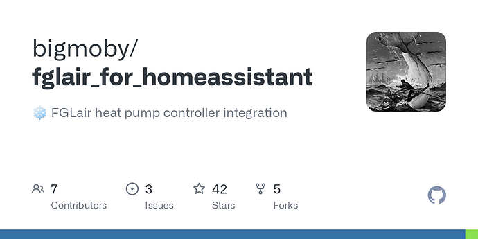

I currently have a Fujitsu AC unit that came with a WiFi module option and I use This integration to control it (just swapped to it now that its more official to be able to install it as I was using a more manual install version for it, had to restart HA every so often when it would not respond to commands so will update if this one does the same):
I have the following automation setup with mine at this time based on my energy provider cost times via schedule helpers and I have cooling/heating and fan controls mapped to my streamdeck xl for quick access to manual controls when at my desk:

Yes if your model does not have an integration at the time then you can use an IR blaster hub to control it, you just need to program it with the remote codes for your model if a profile does not already exist at the time to use (I prefer the integration route as I don’t have to listen to the beeps lol and I don’t want to damage it trying to rip out the speaker that handles that).
