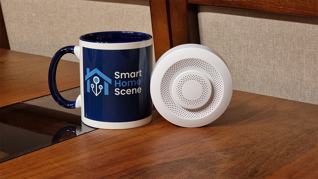

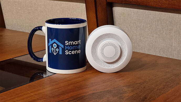

Tuya Zigbee / Wi-Fi Air Quality Sensor
Those Tuya devices do not have real CO2 sensors. They “derive” the value from the VOC sensor. In other words: complete bullshit. They also don’t have a particulate sensor, which is important for assessing air quality.
