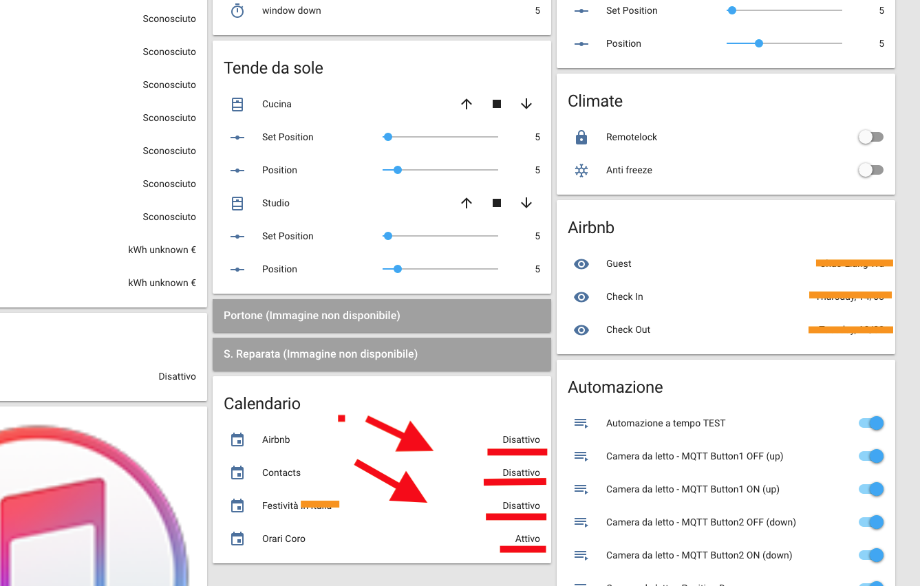

Allow me another question: why in the section of all calendars, some calendars are active and others are off?
-“Airbnb”, is deactivated while in the group is active and works perfectly.
  • “Festività” is off while in google calendar is active
I’m not too familiar with google calendars, but I think it’s only ‘active’/on when there’s a calendar event on and ‘deactive’/off when there’s no calendar event.
Very well everything is clear. Thank you so much for your precious support!!!
