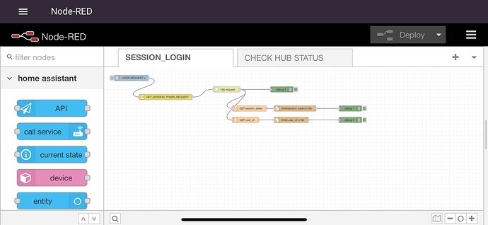

UPDATE: i have obtained the X API token from ajax, now i can use the api documentation for compile a node red automation for manage the ajax hub! I’ve tried to get the status, arm and disarm and it works :slightly_smiling_face:

First sensor……
What information did you fill in the form?
A simple login request, and the response is:
Session token, user id
Then i’ve used an api GET request for obtain the serial of the hub qnd then i have done an htttp request for get get status of the alarm armed/disarmed. I’ve read the state and with a simple read of the msg.paylod:state and put a switch for this with a sensor.
