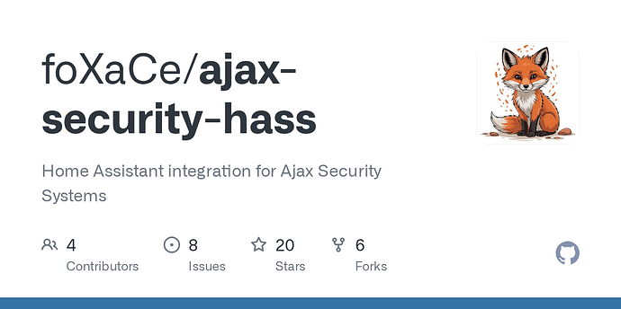

Indeed but so far it works. there is another initiative that looks very promising. Have a look here. Talk directly to Ajax API. Very efficient. Still under development but he goes very quickly.
Looks like that github page has been removed (or made private).
This is my top wanted integration in my home - because it doesn’t exist I’ve not extended my ajax ecosystem
This is looking very good so far! I’m considering getting an Ajax user and email to be able to test - is there anything else I need? I see there’s a public proxy to use - can anyone please post the address of this so that we can test?
