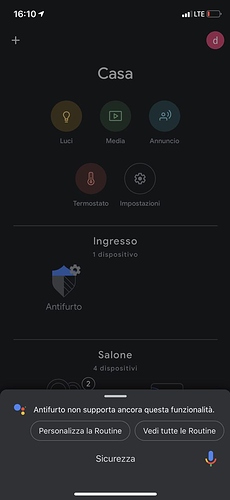

The problem is that the created alarm in Google Home looks like this, and it will not let me do anything a part from showing its informations when i click on it:

This is getting strange… If i create a routine in Google Home, i’m allowed to choose the ā€œarm the security systemā€ and in actually find the Home Assistant alarm panel modes
But, if i trigger the routine, it says that ā€œantifurto does not support this functionality yetā€
