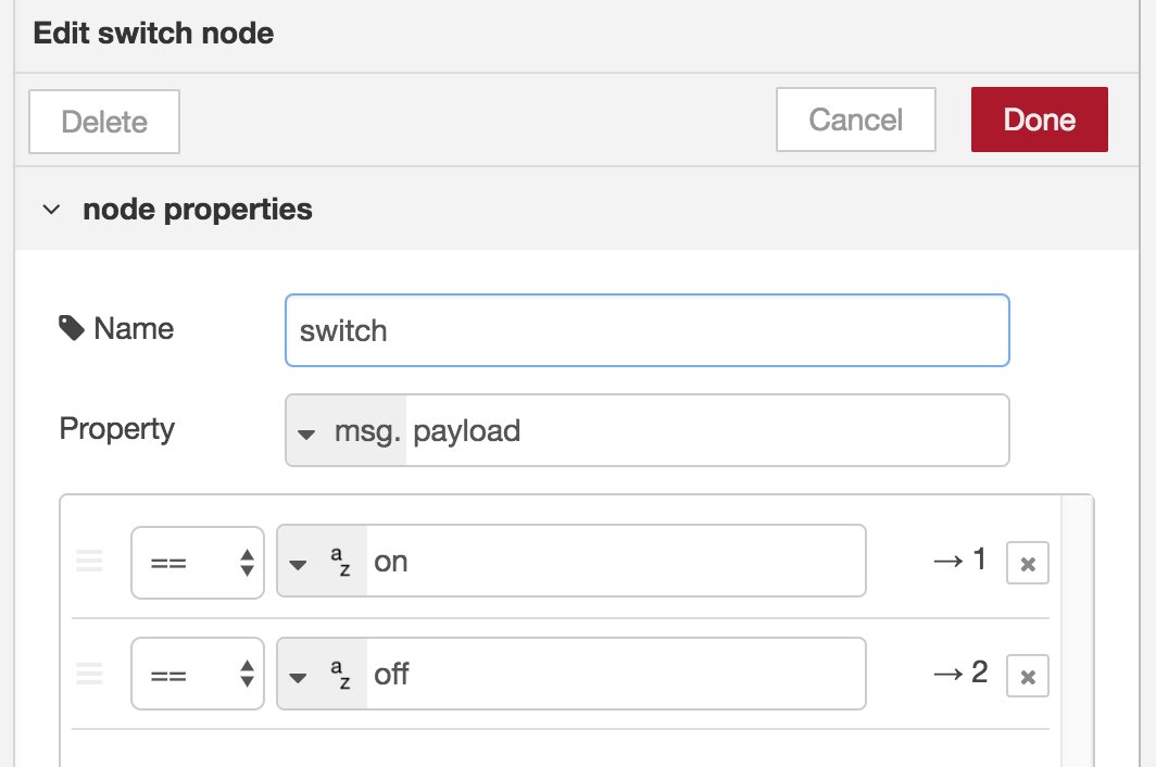

So I took the plunge and installed Node-Red and the local Alexa skill. It was very easy to set up and works pretty good. One question I have for the more experienced users out there is, how would I program a flow that turns a switch/input_boolean on or off based on what I say to Alexa? So right now, I just have it toggle but if it’s already on and I ask Alexa “turn on the Fan” if the state is on, it shouldn’t toggle and turn off. Any ideas?
Hi @Jer78, if you set it up like below using a switch node using ‘is true’ and ‘is false’ this does what you want
@snarby Perfect. That’s exactly what I’m looking for. Thanks!

It doesn’t look like this works with the node-red-contrib-alexa-local so I’m assuming it’s just the node-red-contrib-Alexa-home-skill that passes along the payload. I was hoping to avoid the cloud and use the local node.
