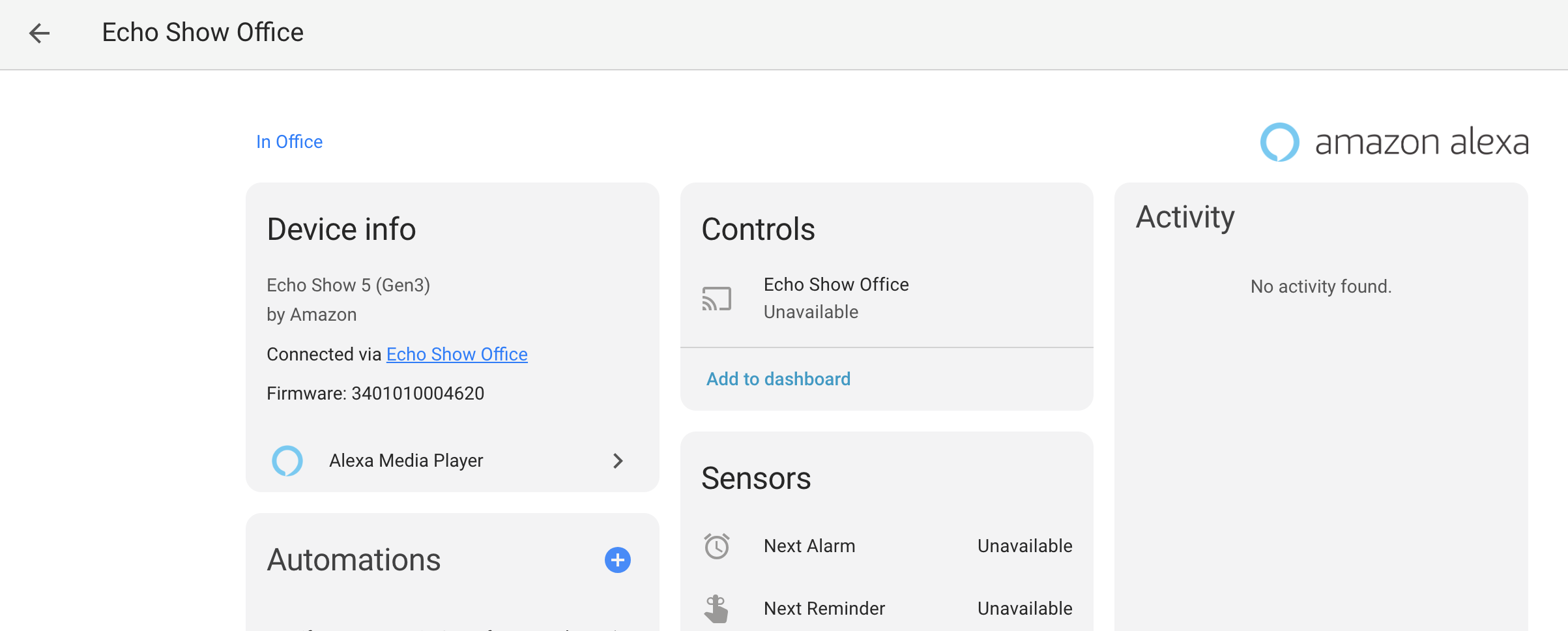

Since updating to HA Core 2025.10.1, all my devices under both the Alexa Media Player and Alexa Devices integrations are showing as unavailable.
I’m using Cloudflare for remote access.
Is anyone else experiencing the same issue?

I’ve just applied the 2025.10.2 update. Unfortunately, all devices under Alexa Media Player still appear as unavailable.
Do I need to remove AMP and install it again?

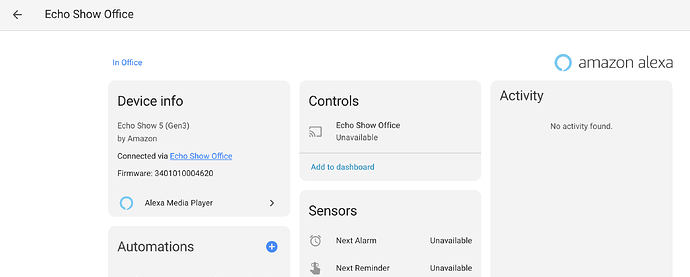

I’m having this issue. Have tried removing and re-adding AMP multiple times, had to re-authenticate multiple times but even when the devices are populated (maybe 20% of the tries) the devices are still unavailable. I was on 2025.10.5 but it was doing the same on 2025.10.4 and is now doing the same on 2025.11.0

I’m experiencing the same issue. Authorisation fails, no matter what I try. It started with the 2025.10.4 core update and persists through the 2025.11.0 update. Frustrating.
