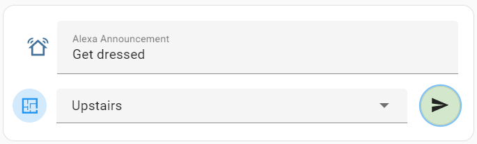

I chose yesterday as a day to sort out all my Alexa announcement routines using AMP (great timing!) and create a dashboard button to handle custom announcements
