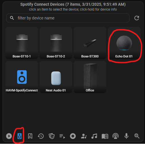

Is there anyway to automate the switching of spotify accounts? My wife and I both have individual spotify accounts and both of our amazon accounts are in my amazon family profile. I have to go in through the alexa app and login with a different account if I want to change which spotify account the echo uses.
@jiggahertz86
I released update v1.0.109 of the SpotifyPlus Integration a couple of days ago that fixes an issue re-awakening Amazon Alexa devices. I was not able to test it with multiple Amazon accounts though, so I can’t say if it will fix this problem or not. It might be worth a try though.
To test:
  1. play some Spotify on the selected Amazon device using your wife’s Spotify account.
  2. from the SpotifyPlus Card using YOUR Spotify account, select the same Amazon device to transfer control.
  1. Or you can issue a service call if you want to do it programmatically (change entity_id to your SpotifyPlus account entity, and device_id to the Amazon device name):
action: spotifyplus.player_transfer_playback
  entity_id: media_player.spotifyplus_todd_l
  device_id: Echo Dot 01
  play: true
The questions I have would be:
  1. do you see the Amazon device in your SpotifyPlus Integration source_list / or in the SpotifyPlus Card device list when your wife’s account has control of the device?
I still might be able to fix this, but would need to do some digging.
If you don’t have the time to mess with it I understand, and no hard feelings.
UPDATE - here’s a list of reddit threads that relate to the same problem.
Hope it helps!

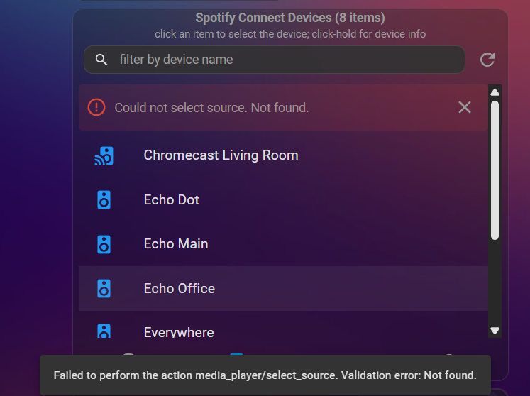

The device does show up in my list but when I try to play to this device this is the behavior:
Calling spotifyplus.player_transfer_playback with my account to the device returns the following error:
2025-05-12 20:19:47.403 WARNING (SyncWorker_29) [spotifywebapipython.spotifyclient] Verification timeout waiting for Amazon Spotif
y Connect device "Echo Office" (74313510-859a-44d3-9411-7536a3d706b7_amzn_1) to become the active device; device not activated wit
hin 5.000000 seconds of Connect
2025-05-12 20:19:47.760 ERROR (MainThread) [homeassistant.components.websocket_api.http.connection] [546699514864] Not found.
@jiggahertz86
At this point, I am not sure if this problem is due to the breaking changes that Spotify made on 05/07 or if it’s related to Alexa processing.
I would suggest removing your SpotifyPlus SP_DC / SP_KEY configuration options, and try the request again.
You could also upgrade to the latest SpotifyPlus version that was released today, which removes those credentials.
The Spotify change removed access to those credentials, and also caused transfer playback errors for any device.
