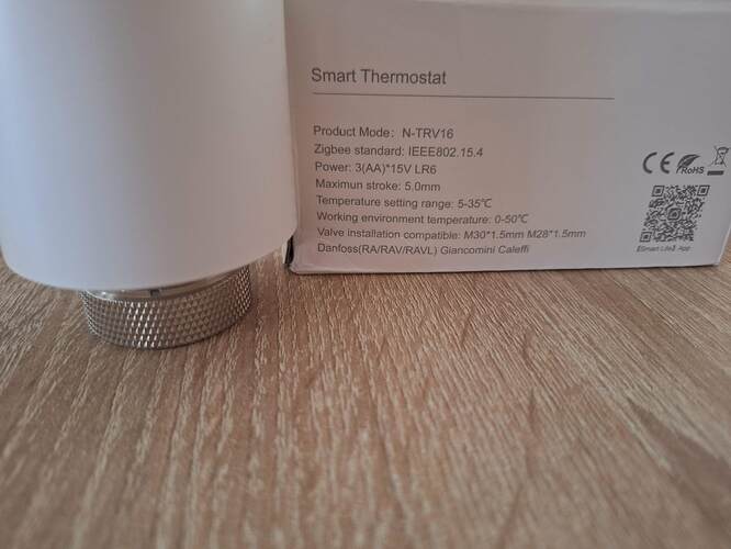

I bought a supposedly AVATTO branded TRV, although the packaging didn’t reveal this. It’s an N-TRV16 by it’s label.

Does the device work for you now? I have the same one and while I can connect it using ZHA it does not list anything under Configuration/Diagnostic in the device info apart from LQI and RSSI. Do you see temperature controls etc. there?
Update: found a solution, my device was a different variant which needed a quirks file. For anyone running into this too here is the fix
