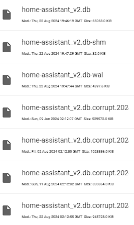

There seems to be also a corrupt DB file:
Im using standard DB (SQLite?!)

It sounds like you have a major problem with the database.
Based on that I’m going to predict that you have a ras-pi of one form or another using an SD card, further that the SD card has failed. All SD cards fail. Generally the cheaper they are the sooner they fail.
