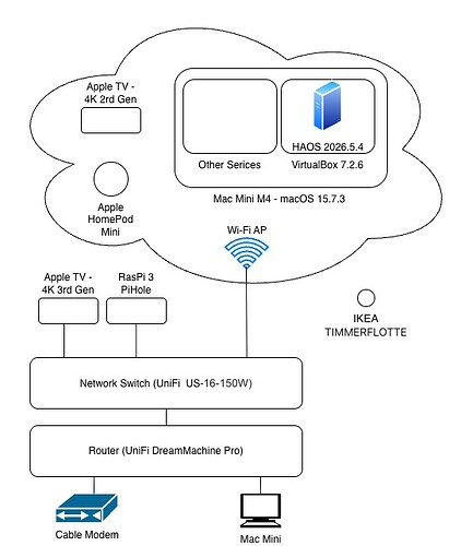

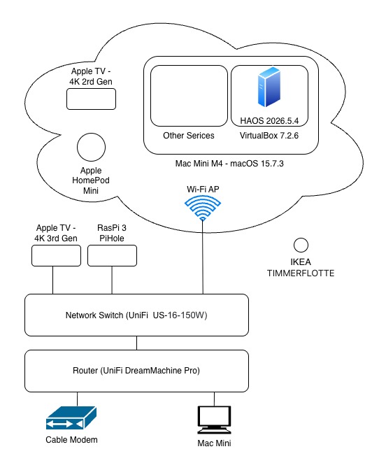

  • HAOS VirtualBox image is running in a VirtualBox VM, VirtualBox is running on an MacMini. The Mac Mini is connected via Wi-Fi (it's located somewhere where I can't run ethernet).
  • My HAOS instance doesn't have a prefered Thread Network, but it reports both Apple TVs as border routers.
  • A UniFi Dream Machine Pro does all the routing and IPV4 DHCP, using a PiHole instance to provide DNS for the whole network.

Your sensors are reporting to AppkeTV, since you can see the values change in Apple Home.
You can not see values change in HA.
That means your issue is with the link between AppleTV and HA.
Agreed.
The sensors are reporting data to Apple Home, HAOS was recording the data from those sensors, and at 8pm one eveing all 6 sensors became unavailable to HAOS while continuing to work with the Home app.
So it appears that something between my border routers (2 x Apple TVs and 1 x HomePod mini) and my HAOS instance 'broke'.
My issue is that I don't currently know enough about HAOS, Matter/Thread, and IPV6 to know where to start investigating.
