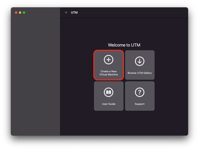

Click on the “Create a New Virtual Machine”

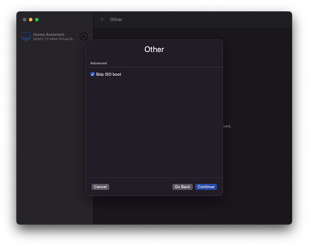

Select “Other”
Follow through or play around the settings as you like
We will remove this virtual disk in the process, just use the default for now
