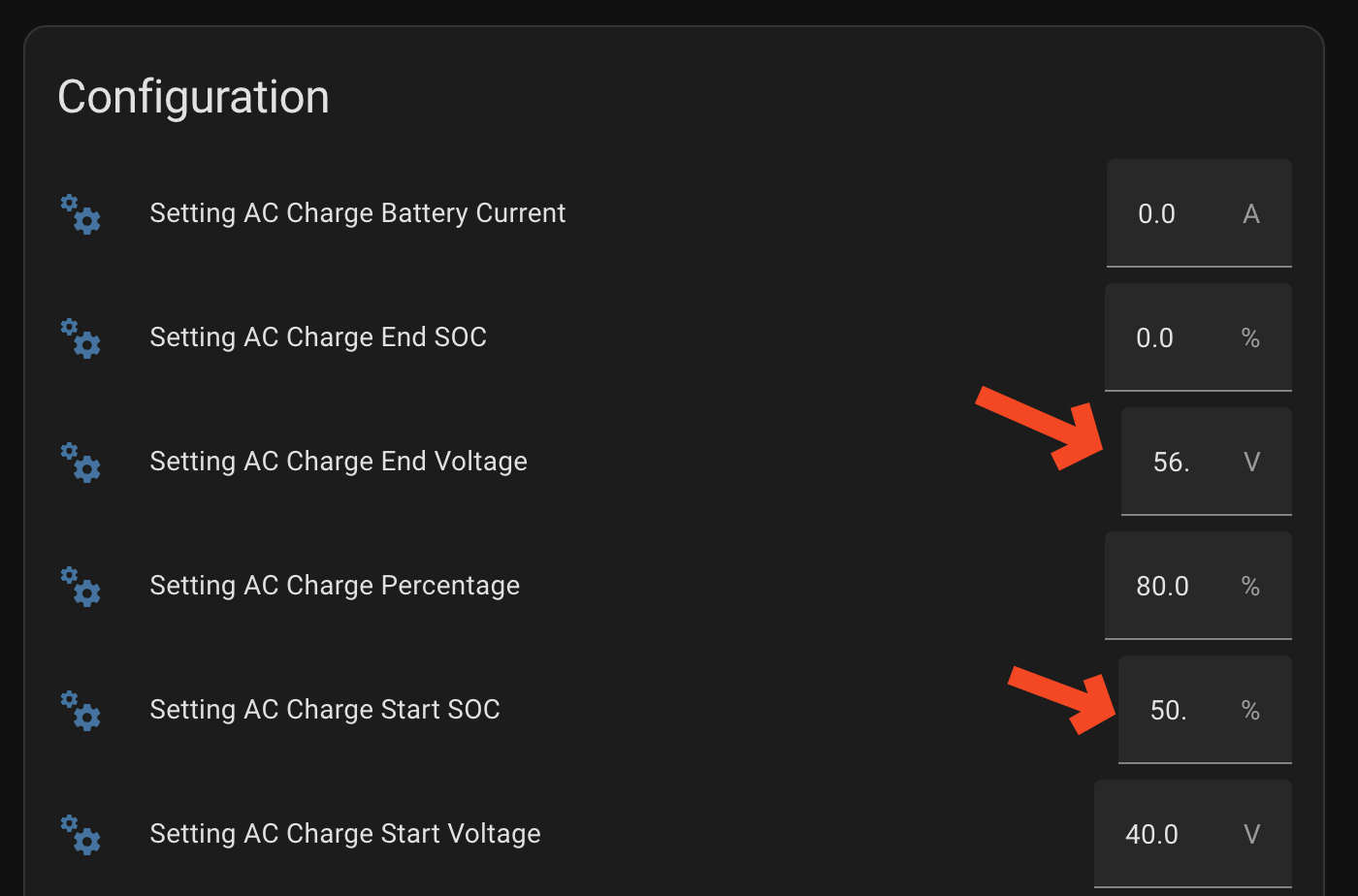

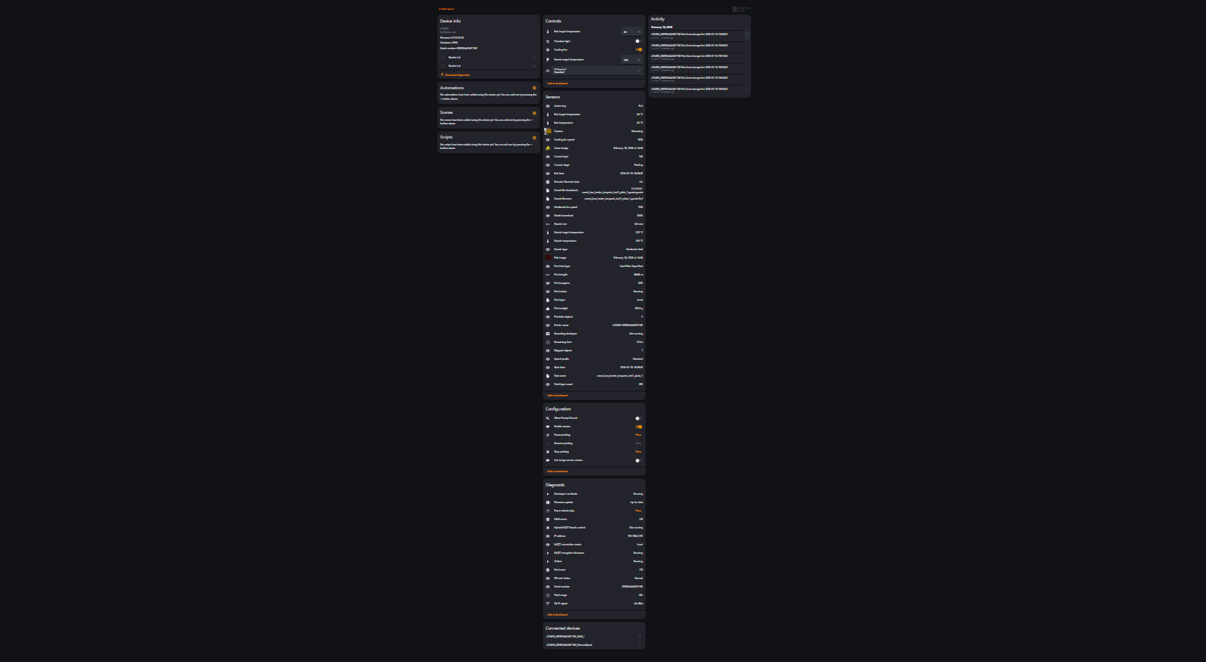

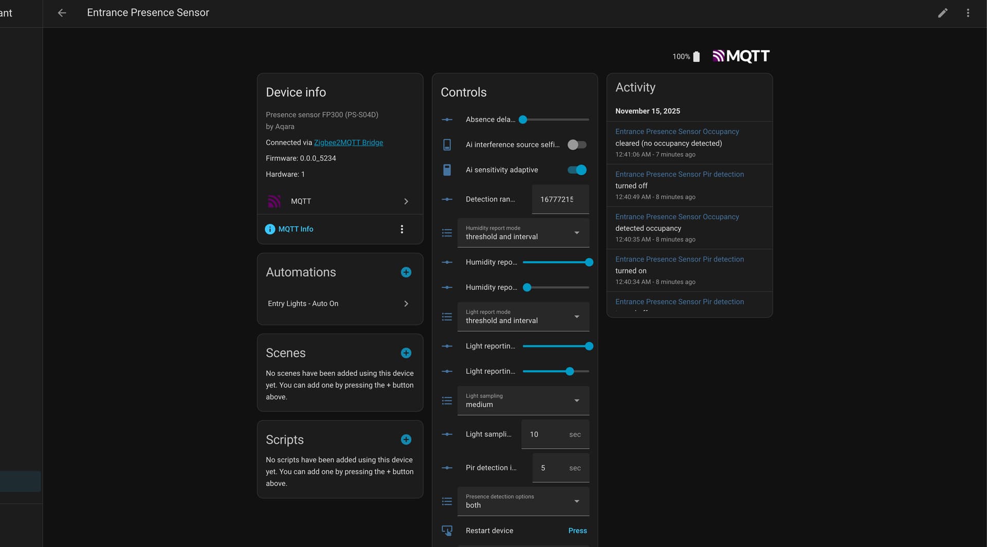

Allow columns in Device Info - Settings to be resized or scale to screen width
It seems that when in the Settings>Devices & Services> Devices Tab> Pick a drive - the Device Info that are shown in columns do not size well to the page. When there are sliders for example the actual entity name is completely hidden from view making it hard to see what each parameter is.
I feel it should either scale better width wise, or handle the text better by wrapping it down so you can see all of it. Auto handling it would be best, but at least the option to adjust column width in settings here would be a start.
Additionally if the entity name is very long, when you click the entity to open up the popup for that entity the name can also be truncated vs wrapping the name so you can see it completely.
Please find the attached pictures for reference.
I will be linking two other posts in the forums to here to hopefully gain traction on this.
Thanks!

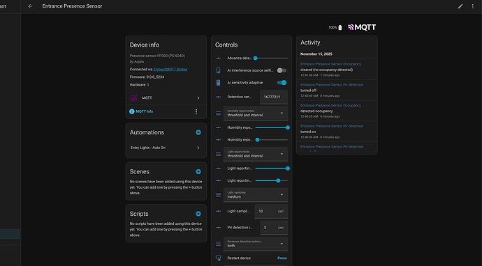

I second this but I think that solution should be increasing the width of the middle column rather than all three of them uniformly as that would just waste space too.
Cheers!
I’d like the columns drag-resizeable please. If that’s not possible then have the entity-ID column wider at least as the full text rarely fits in

Not sure why the decision was made to force the container to a static width of 1000px.
Using the code snippet below should remove the max-width property from the container if pasted into the dev console. Now to figure out how to inject it reliably whenever I visit a device page.

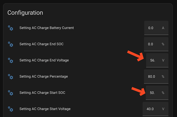

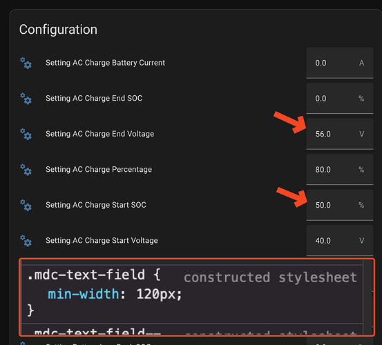

@Ildar_Gabdullin - I’m trying to do something similar for the configuration column within the page but failing to get the correct syntax. Any chance you can help:
If I select the <label class="mdc-text-field mdc-text-field--no-label mdc-text-field--filled ">, the Styles tab shows
.mdc-text-field {
    width: 100%;
If I change this from width to instead set a min-width, it fixes the UI:
But my attempts to put it into device_page_wide.js aren’t successful at fixing the UI:
  const newStyle = css`
  hass-subpage > .container {
    max-width: 90%;}
  hass-subpage > .mdc-text-field {
    min-width: 120px;}
Any help is appreciated!

I would want a general redisign of this page in the future, since the columns are often very unbalanced.
I have quite a wide screen and would be happy about more then 3 columns.
Stuff like device info and Activities could be in its own container at the top, rest could somehow float to fill the space.

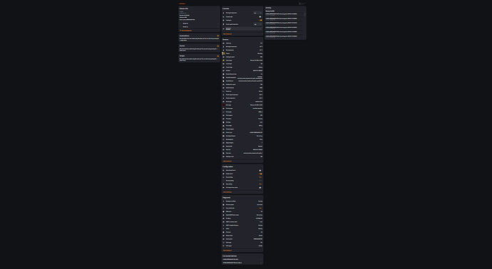

Here is a more complete alternative that allows dragging and resizing columns.
Put a file named adaptive-ha-device-page.js into /config/www/
Then put the entry into the configuration.yaml
Restart home assistant
Reload browser cache with ctrl+shift+r

          width: 4px;
        :host([narrow]) .${HANDLE_CLASS} {
          display: none !important;
    return `
      /* Page container */
        max-width: ${containerMaxWidth} !important;
      /* Per-column rules */
      ${columnRule(1)}
      ${columnRule(2)}
      ${columnRule(3)}
      /* Multi-column entity grid */
      ${subColumnsRule}
      /* Drag handles */
      ${handleCss}
      /* Mobile: stack everything vertically */
      :host([narrow]) .container > .column {
        width: 100% !important;
        max-width: none !important;
        column-count: 1 !important;
        contain: none !important;
        flex-basis: auto !important;
  // ----------------------- Drag handle logic -----------------------
  const lockColumnWidth = (col, widthPx) => {
    col.style.flex = `0 0 ${widthPx}px`;
    col.style.maxWidth = "none";
    col.style.width = `${widthPx}px`;
  const unlockColumnWidth = (col) => {
      "flex",
      "flex-grow",
      "flex-shrink",
      "flex-basis",
      "width",
      "max-width",
    ].forEach((p) => col.style.removeProperty(p));
  const setupResizeHandles = (devicePageEl) => {
    if (!CONFIG.resizable) return;
    const root = devicePageEl.shadowRoot;
    if (!root) return;
    const container = root.querySelector(".container");
    if (!container) return;
    const columns = Array.from(
      container.querySelectorAll(":scope > .column")
    if (columns.length < 2) return;
    // Clean slate.
    container
      .querySelectorAll(`.${HANDLE_CLASS}`)
      .forEach((h) => h.remove());
    columns.forEach((col, idx) => {
      // Restore any saved width for this column.
      try {
        const saved = parseFloat(localStorage.getItem(LS_KEY(idx)) || "");
        if (!Number.isNaN(saved) && saved > 100) {
          lockColumnWidth(col, saved);
      } catch {
        /* localStorage blocked — ignore */
      // Insert a handle after every column except the last.
      if (idx === columns.length - 1) return;
      const handle = document.createElement("div");
      handle.className = HANDLE_CLASS;
      handle.title = "Drag to resize • Double-click to reset";
      col.insertAdjacentElement("afterend", handle);
      let startX = 0;
      let startWidth = 0;
      let dragging = false;
      const onMove = (e) => {
        if (!dragging) return;
        const delta = e.clientX - startX;
        const newWidth = Math.max(
          CONFIG.minColumnWidth,
          startWidth + delta
        lockColumnWidth(col, newWidth);
      const onUp = () => {
        dragging = false;
        document.body.style.cursor = "";
        document.body.style.userSelect = "";
        document.removeEventListener("mousemove", onMove);
        document.removeEventListener("mouseup", onUp);
        try {
          localStorage.setItem(
            LS_KEY(idx),
            String(col.getBoundingClientRect().width)
        } catch {
          /* ignore */
      handle.addEventListener("mousedown", (e) => {
        startX = e.clientX;
        startWidth = col.getBoundingClientRect().width;
        dragging = true;
        document.body.style.cursor = "ew-resize";
        document.body.style.userSelect = "none";
        document.addEventListener("mousemove", onMove);
        document.addEventListener("mouseup", onUp);
        e.preventDefault();
      handle.addEventListener("dblclick", () => {
        unlockColumnWidth(col);
        try {
          localStorage.removeItem(LS_KEY(idx));
        } catch {
          /* ignore */
  // -------------------------- Style injection ---------------------
  const injectInto = (root, content) => {
    if (!root) return;
    let style = root.getElementById?.(STYLE_ID);
    if (style) {
      style.textContent = content;
      return;
    style = document.createElement("style");
    style.id = STYLE_ID;
    root.appendChild(style);
  // Walk into shadow roots — needed for already-mounted instances.
  const findAll = (root, tag) => {
    const out = [];
    const lower = tag.toLowerCase();
    const walk = (node) => {
      if (!node) return;
      if (node.nodeType === 1 && node.tagName?.toLowerCase() === lower) {
        out.push(node);
      if (node.shadowRoot) {
        for (const child of node.shadowRoot.children) walk(child);
      for (const child of node.children || []) walk(child);
    walk(root);
    return out;
  const applyAll = (devicePageEl) => {
    injectInto(devicePageEl.shadowRoot, buildCss());
    // Run on next frame so the columns exist in the DOM.
    requestAnimationFrame(() => {
      setupResizeHandles(devicePageEl);
      // Force a synchronous layout pass so the multi-column
      // fragmentation has fully settled before the user can open
      // any dropdowns. Without this, getBoundingClientRect() in
      // HA's dropdown library can return a stale rect and anchor
      // the popup a few pixels below where the icon ends up.
      const c = devicePageEl.shadowRoot?.querySelector(".container");
      if (c) void c.getBoundingClientRect();
  // -------------------------- Patch the element -------------------
  customElements.whenDefined("ha-config-device-page").then(() => {
    const DevicePage = customElements.get("ha-config-device-page");
    if (!DevicePage) {
      console.warn("[adaptive-device-page] element not found");
      return;
    const origFirstUpdated = DevicePage.prototype.firstUpdated;
    DevicePage.prototype.firstUpdated = function (...args) {
      const r = origFirstUpdated?.apply(this, args);
      applyAll(this);
      return r;
    // If HA re-renders and our handles get blown away, put them back.
    const origUpdated = DevicePage.prototype.updated;
    DevicePage.prototype.updated = function (...args) {
      const r = origUpdated?.apply(this, args);
      if (CONFIG.resizable) {
        const c = this.shadowRoot?.querySelector(".container");
        if (c && !c.querySelector(`.${HANDLE_CLASS}`)) {
          requestAnimationFrame(() => setupResizeHandles(this));
      return r;
    // Patch any instance already on the page when the script loads.
    findAll(document.body, "ha-config-device-page").forEach(applyAll);
    console.info("[adaptive-device-page] loaded");
