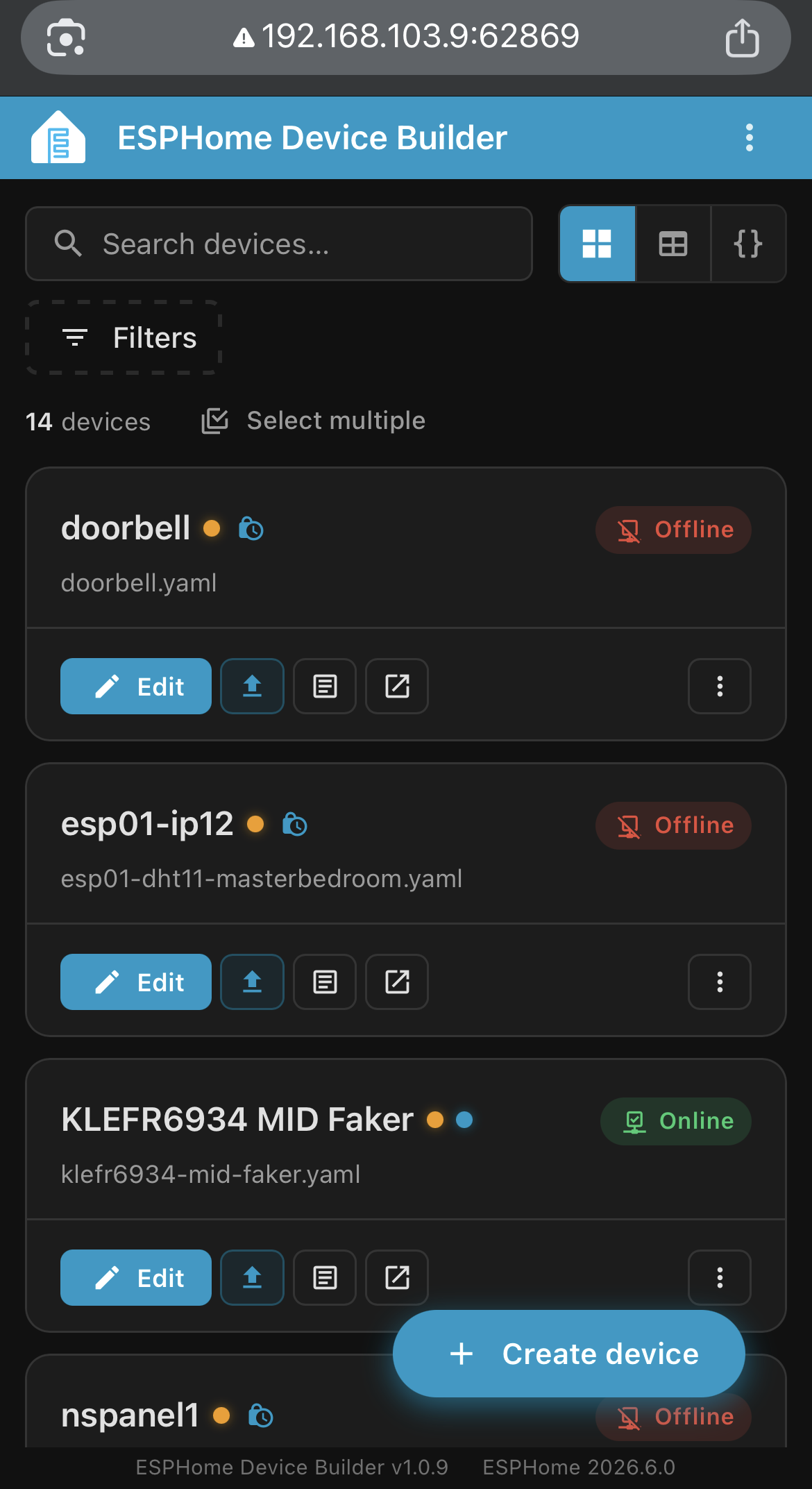

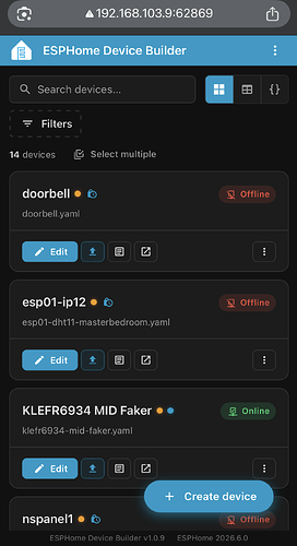

`======== Running on http://0.0.0.0:62869 ======== `
http://<ha’s.address.ip>:62869

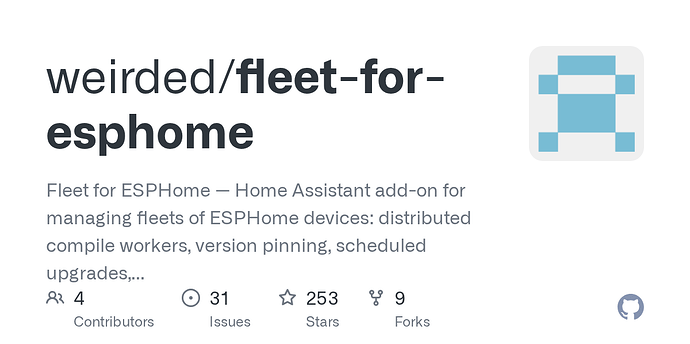

I haven't tried this yet, but also a very interesting approach:

I saw that tool recently too ... I don't think I really want to try a third party tool to manage esphome ATM...I'll prob stick to first party bc it's changing so much right now. If you decide to try it let me know if you like it!
Special thanks to @aceindy - works! I did not see that log line as I only saw the ominous "Ingress only" log
