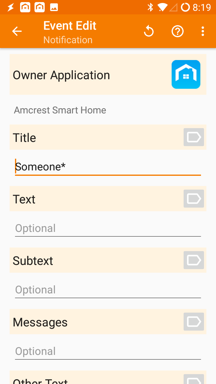

You first need to set up a Tasker profile to react to SmartHome App alert notifications. From the Tasker profile tab main menu, tap + to select Event , then UI, then Notification. Tap Owner Application and select Amcrest SmartHome. Then in the Title field, enter Someone*. This will trigger when the doorbell button is pressed and the notification says “Someone is at your <name of doorbell>”.

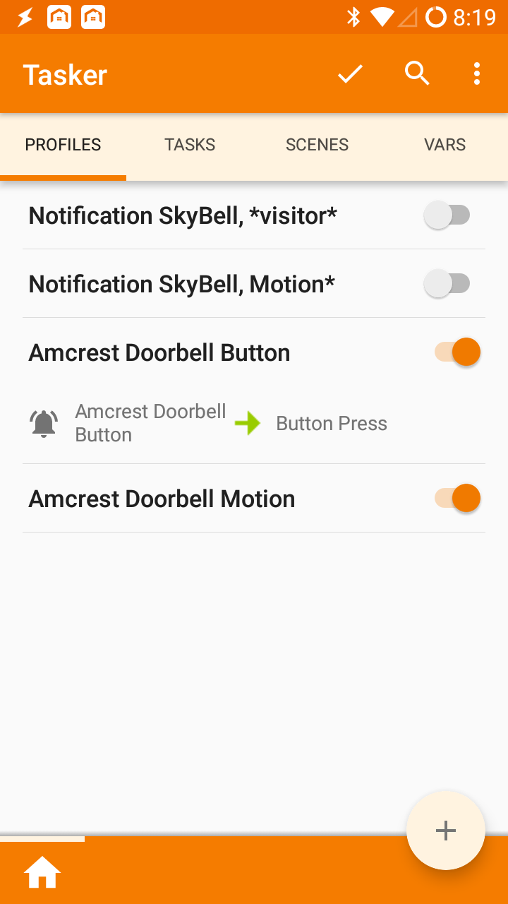

I’ll also include some screen captures here to help clarify the Tasker configuration. Below is the home screen from an old Android phone dedicated to running Tasker and SmartHome. Here it is showing the two SmartHome alerts Tasker will recognize. (Ignore the “No active profiles” Tasker message, that is normal).
Below is the main menu from Tasker where both doorbell button press and motion SmartHome notifications are triggered. I have renamed them from the default names. (Ignore the Skybell info, that is what I had before replacing it with the AD110). :grinning:
This is all that is needed to recognize a doorbell press notification “Someone is at your …”

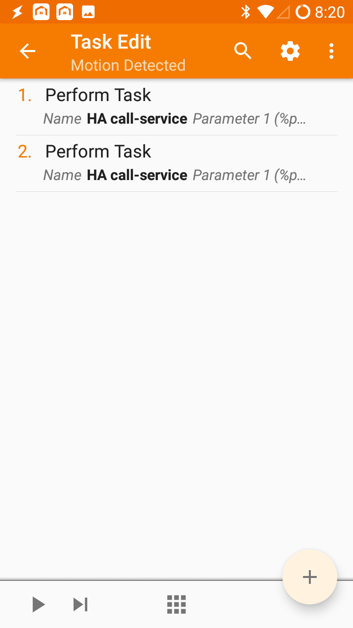

And here is the action taken to signal HA via an input_boolean switch…
The first task is to turn on the boolean switch, then the second it to turn it off.
