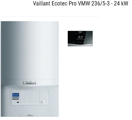

Hi all, i need hel on VALLIANT ecoTEC pro 236 VMW.
caldaia
Equipment:
0010021995 - Caldaia Vaillant EcoTEC Pro a condensazione VMW 236/5-3
0020260943 - Termostato Caldaia Vaillant sensoHOME 380
I install adaptor and config ebusd addon , they work it.
I found all sensor and i cant control system thermostat
example:
BUT I CANT keep temperature room and heat. I cant use thermostat in home assistant?
So wrong config to csv i have auto discover.
Help

Where can I find the results of a full scan? Open the IP:Port doesn’t work.
grafik
