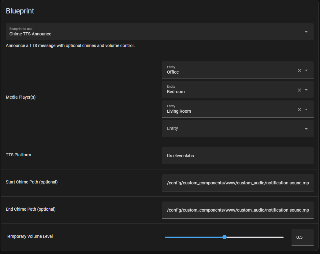

@nownaga here is what I (Chat GPT) built off of @balloob’s blueprint. I have an MP3 that plays before and after the announcement saved in /config/custom_components/www/custom_audio/. For TTS I use ElevenLabs, they have some great sounding voices, much better than the Google TTS.
This video was also helpful in getting this up and running: https://www.youtube.com/watch?v=L9r177hSBc0

Here is how I set things up in the Blueprint:
I then have a Chip on my dashboard that allows me to enter my announcement.
I hope this helps get you moving in the right direction!
