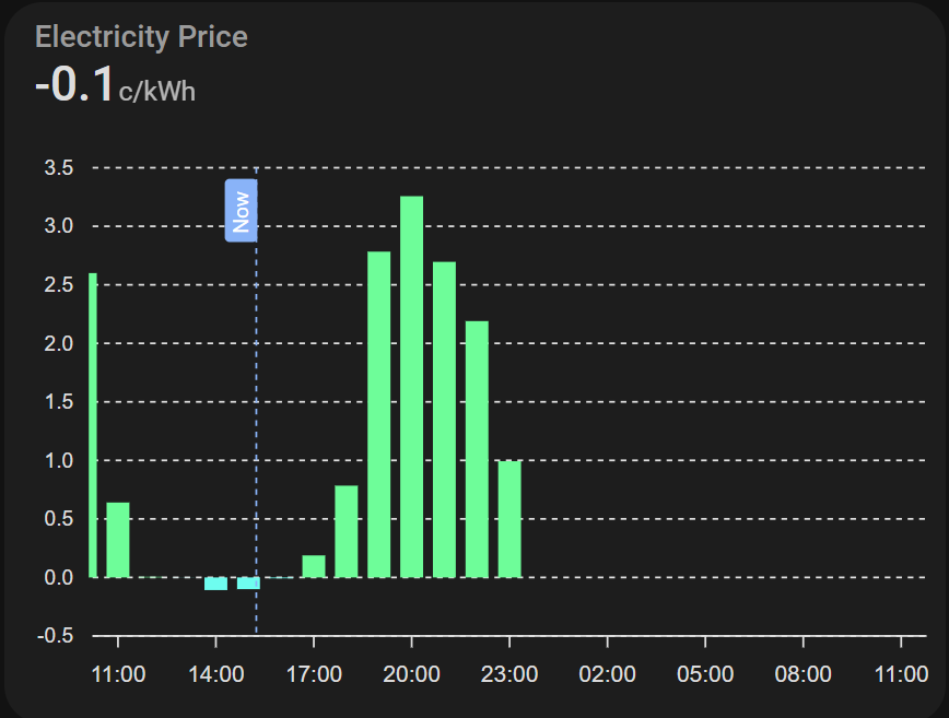

Any good ideas are welcome. Nordpool Energy Price per hour
Is it possible to put value in the “now lable”?

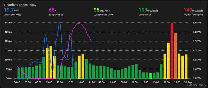

I just wanted to share my integration with lovelace. Works also in light mode but colors need to be adjusted.
  - type: "custom:apexcharts-card"
    graph_span: 1d
    span:
      start: hour
      offset: -4h
    experimental:
      color_threshold: true
    all_series_config:
      color_threshold:
        - value: -1
          color: "#6EFDEF"
        - value: 0
          color: "#6EFD99"
        - value: 10
          color: "#FDE86E"
        - value: 20
          color: "#FD6E6E"
      type: column
    series:
      - entity: sensor.***YOUR NORDPOOL SENSOR***
        data_generator: |
          return entity.attributes.raw_today.map((entry) => {
            return [new Date(entry.start), entry.value];
        show:
          in_header: false
        data_generator: |
          const now = new Date();
          let latestData = entity.attributes.raw_today[0];
          entity.attributes.raw_today.forEach(entry => {
            const entryDate = new Date(entry.start);
            if (entryDate <= now && (!latestData || entryDate > new Date(latestData.start))) {
              latestData = entry;
          return [[new Date(latestData.start), latestData.value]];
        show:
          in_header: true
          name_in_header: false
          in_chart: false
    now:
      show: true
      label: Now
    header:
      show: true
      title: Electricity Price
      show_states: true

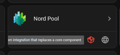

Well, the HACS version does not work any more for me when I updated to 2024.12.0. It does not get loaded and complains about the ‘config flow’. Am I the only one with problems with the HACS version?
Thanks for the info. Since I rely heavily on the HACS version, what do you suggest med to do? I haven’t updated yet to 2024.12 just because if this…
Yes, that cost me a few hours yesterday. Tried to get the official integration working with the Apex charts “standard” code for Nordpool but realized much to late that the essential attributes where not available in the new rendition of Nordpool. Will sit on my hands for a while, waiting for an update there… With the new effect tariffs arriving I guess a broader audience would long for all sorts of e.g. best time for charging-functionality etc. of sorts.
I have been running 2024.12 since beta1 and am now running 2024.12.1.
The old HACS integration is still working fine and is reported as replacing the official integration.
If it stopped working for you, I suggest to check if it is the latest version (0.0.16).
Even so, I do question if it was wise to add a new official integration with identical name as an existing and popular custom one - especially as the official integration still is inferior to the old.
For me the old/custom integration still works as before after updating HA to 2024.12.x. I did not add the official integration.
Only difference is that now the custom integration icon is red instead of orange and hovering the mouse over it displays a message:
I got it running now. The python path inside the HA container does not find the dependencies, so I had to go into the container filesystem and fix the python path for python 3.13 so that it would work. It works now iaf
Same here.
As I was sloppy in reading the 2024.12 release note I was not aware of the now core integration. The HACS integration works unchanged.
