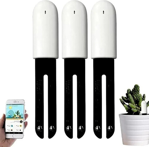

Mi flora with BLE moisture, pH and nutrition values.
I haven’t got them yet but a review says they work with HA.

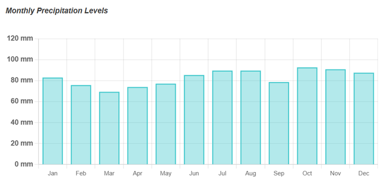

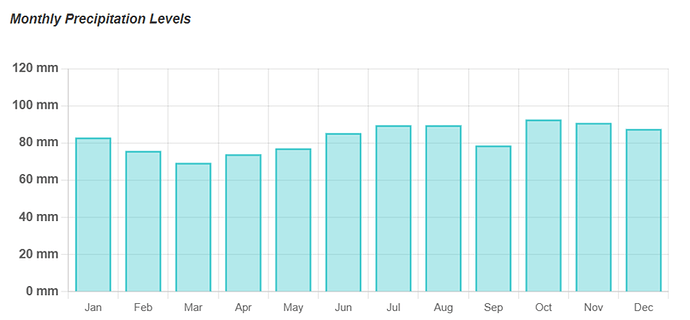

I tend to know when to water my plants outside that are in pots when I am away from home. I currently use my cameras to see if it’s been raining and if plants are wilting. It tends to rain here a bit more, except when I go on holiday. Then there is a drought. I run a script to water my plants. Again it’s the gardener in me that wants to decide when to water.
It rains here alot.

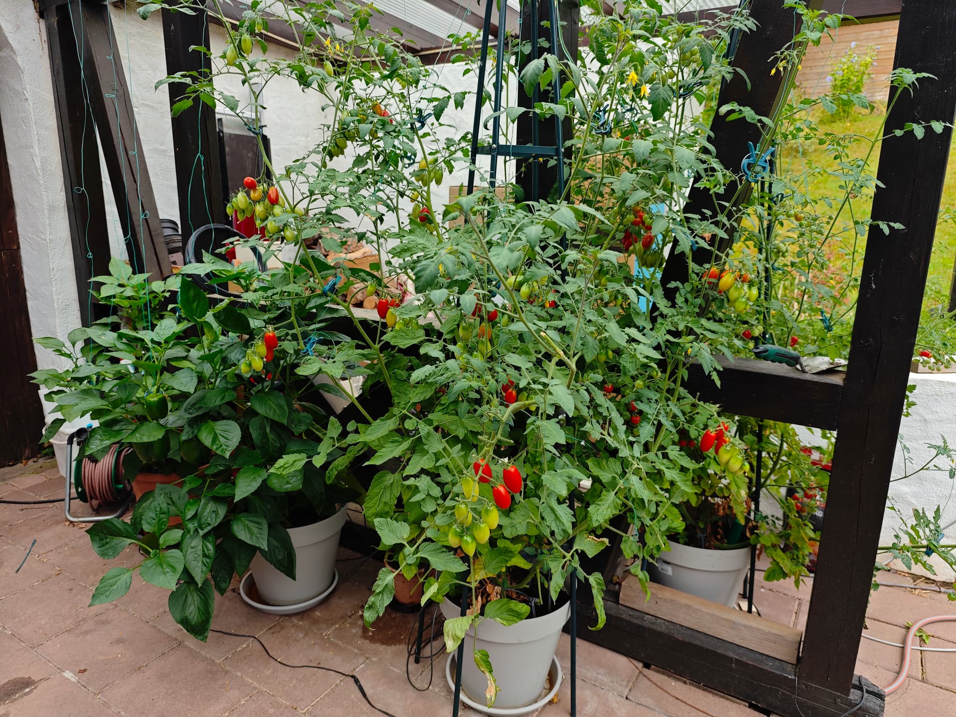

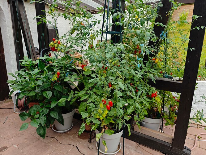

I’m using the sensor mentioned for potted plants (tomatoes, peppers etc.) under on my veranda. It has a transparent roof & is open to two sides. Even if the sensor seems to report the ambient temperature above the soil, it is enough for me to compensate the fluctuation in humidity measurements. I assume that the temperature in the pot might be around the same with a little delay.
Regarding the reported values: I don’t care much - as long as the variation helps me to prevent the plants from drying dead.
I’ve just put the sensor in the pot of the tomato that I assumed to be the thirstiest and adjusted irrigation in a way that the soil always feels moist, but no excess water is being collected in the coaster of the pot. The other plants receive a relative amount of water compared to the measured pot. Since I use a strange Gardena Pump & distribution system that originally is designed to run 1 pumping cycle / 24h, but runs a cycle whenever it’s disconnected from power and being connected again, it leads to many small cycles throughout a day. Since the plants grow fast, the number of cycles is increasing throughout the summer.
For me that’s good enough & I enjoy plenty of tomatoes, peppers & stuff.
