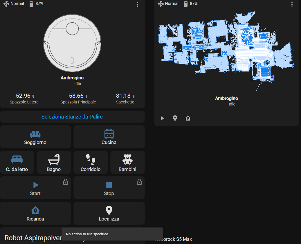

Hi, I have follow guideline present at this website:
I have successfully create a card with map and I’m able to start, pause, stop and back to dockstation the robot. But when I try to select a specific room no action is execute.
I have execute many checks and everythin is aligne to the guideline
On Dashboard I can see this message “no action to run specified”. Anyone can help me?
