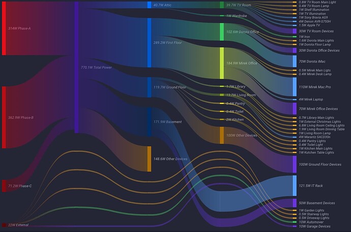

OK, i played with new skip section function and it is nice… though not always working as expected. Here are my observations and few screenshots where representing different outcomes. So, I made some section skip on the very bottom part of card, making it stright from section 1 to 5. Not exactly what I expected. While I understand some ‘waviness’ as card is trying to redistribute available space between connections on each level (and this is fine), more troublesome result is visible in section 4, where connections are unnecessarily crossing each other. I guess that is because card is somehow randomly building dummy entries to supplement missing data on specific section level, perhaps starting from the very first section (so later on these are showing higher on the list)…
Strangely moving this skip block one section further causes issue to reapear. Again card drawing first strictly defined blocks and then adding dummy one:
So definitely this requires some play to have it done properly
Another question, would it be possible to implement somehow section skip funtionality for remaining values? As you can see on my screenshots I have in section 3 quite significant element with remaining and woul dbe nice to display it directly in the very last section. Now to make it it would be necessary to create another virtual sensor that would calculate this value and to place it last section… just an idea…

I’m using Sheely 3EM to measure energy consumption, but unfortunatelly I did not have enough space to install it next to main grid connection (or rather I have not enough space to install clamps), instead it is installed in main fuses box inside the house. That means that connection to garage (which is other building) is made before place where I can make measurements. So external represents everything that is installed in garage or powered from garage building. Technically it is one of these 3 phases, but Im just not capturing consumption on this part of installation. As such I’m using Powercalc to estimate consumption there.
Because your level 2 section entities are different than one specified as children in section 1…
Though it is a biot strange, as they SHOULD show, but disconnected from section one sensor…
