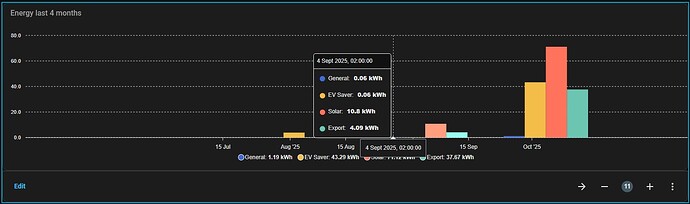

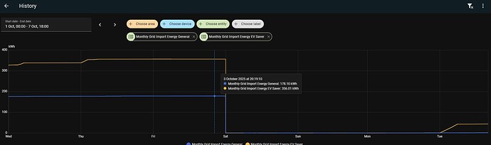

I have a custom:apexcharts-card chart that is not displaying correctly. The issue appears to be that the start of the month is offset by 3 days, the results of the electricity billing cycle which starts on the 4th of each month. I have included the coding for the graph and for the utility meters that generate the results, plus images of the results. The issue is:
The issue is the difference in the values displayed and collected:

It appears that the duration in group_by for the series does not work for months. This would be the issue in this case.
Craig
Indeed, the doc mentions this (not too clear but it is there). The alternative is to use statistics which can come grouped by month (is based on HA func.). I am working on a PR to improve the monthly-grouping in Apex but it takes time :slight_smile:
EDIT: and I can recommend to search & post in the large/huge one, which gets more attention, I myself only bumped into yours by coïncidence.
