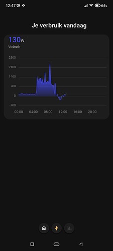

Hi, sorry I don’t have an answer to your question.
But could you share your graph configuration?
I really like how you (almost) got the same style and colors as the Homewizard app.
Been trying to achieve the same.
