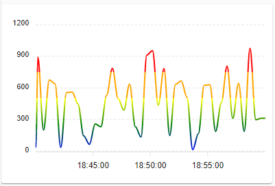

So I’m willing to introduce the color_threshold feature but at the same time it breaks some default stuff (there are bugs in the ApexCharts library). I’m thinking about still releasing it but as an experimental feature…
enabling the experimental flag would render apex_config.fill completely unusable (and if you use it, it will break)
What do you think?
- type: custom:apexcharts-card
  graph_span: 20min
  experimental:
    color_threshold: true # that's new
  series:
    - entity: sensor.random_0_1000
      type: area # or line or column
      stroke_width: 2 # that's new
      color_threshold: # that's new
        - value: 0
          color: blue
        - value: 250
          color: green
        - value: 500
          color: yellow
        - value: 500
          color: orange
        - value: 750
          color: orange
        - value: 750
          color: red
        - value: 1000
          color: red
Did you notice that the first three colours blended but the rest have hard transitions?
Yeah, that’s part of the test :slight_smile: If you look at the config, those are repeated twice with just different values and it generates this “hard” stop effect.
