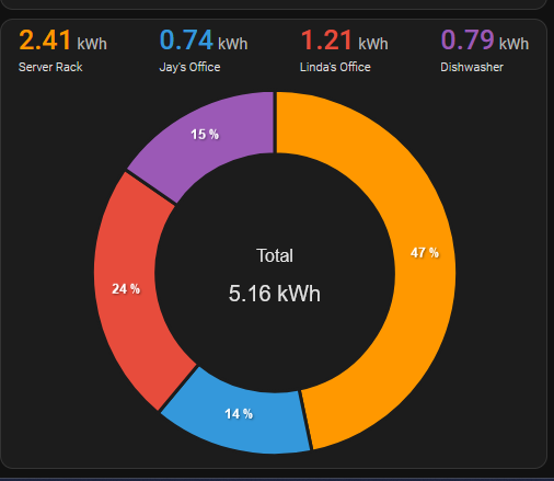

How do you format the values of a slice in a donut chart?
Screenshot 2025-01-16 165320
Screenshot 2025-01-16 165504
I thought this might work, but it does not.
type: custom:apexcharts-card
chart_type: donut
header:
  show: true
  show_states: true
  colorize_states: true
apex_config:
  chart:
    height: 400
  legend:
    show: false
  dataLabels:
    formatter: |
      EVAL:function(value) {
        return value.toFixed(0) + " %";
  plotOptions:
    pie:
      donut:
        labels:
          show: true
          name:
            show: true
          value:
            show: true
            formatter: |
                return value.toFixed(2) + " kWh";
          total:
            show: true
            label: Total
            formatter: |
              EVAL:function(w) {
                return w.globals.seriesTotals.reduce((a, b) => {return (a + b)} , 0).toFixed(2) + " kWh"
series:
  - entity: sensor.server_rack_energy_today
    float_precision: 2
  - entity: sensor.jay_s_office_energy_today
    float_precision: 2
  - entity: sensor.linda_s_office_energy_today
    float_precision: 2
  - entity: sensor.dishwasher_energy_today
    float_precision: 2

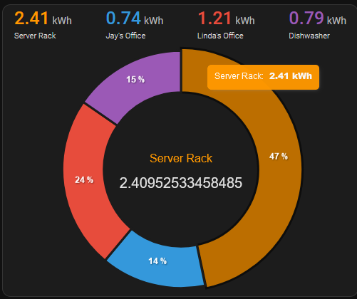

I think you’ve misunderstood. I want to format the value inside the donut to two decimals. For example, if I click on the Server Rack slice, I want to see 2.41 kWh inside the circle, not 2.40952533458485. Similar to how the Total value displays.
I copy from your post : “values of a slice”
And now you are adding more conditions…

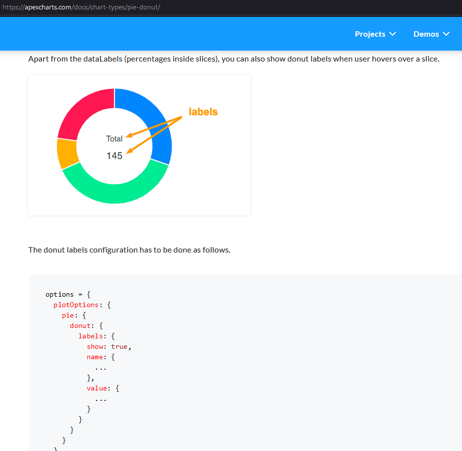

Most the stuff is here but I guess you already found that
pie – ApexCharts.js
You would have to use javascript alike
  plotOptions:
    pie:
      donut:
        labels:
          show: true
          total:
            show: true
            label: LABELNAME
            formatter: |
              EVAL:function(w) {
Well, no, I’m not. You continue to misunderstand the question.
If you look at my yaml, you’ll see that I already have that in place for TOTAL and it works just fine. However, if I click on one slice of the donut, SERVER RACK for instance, it displays a lengthy number with 12 decimals. That is the value I want to configure to two decimals.
