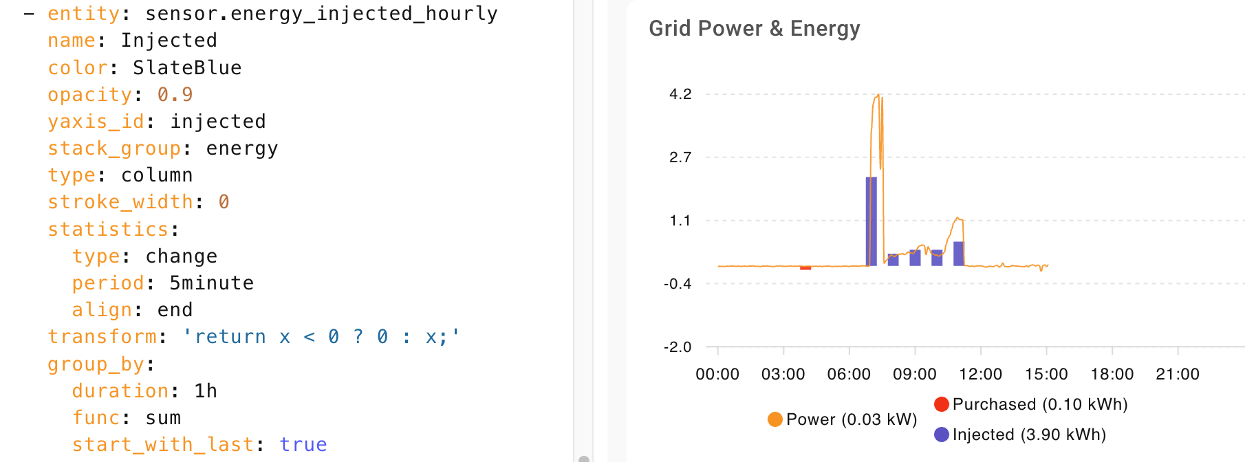

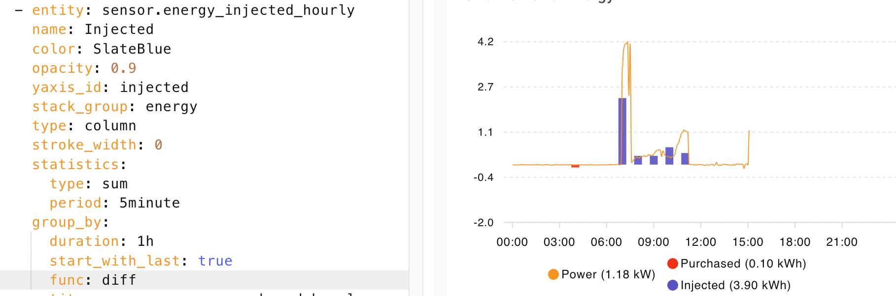

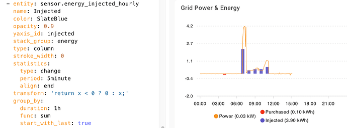

Your settings leads my graph to displaying incorrect results.
Here is the reference:
With settings listed by me in the previous post (taken from the linked article), it calculates values for periods correctly
My assumption is, that the SUM has to be calculated by statistics part. Then diff calculates difference between periods (duration).
Interesting. When I have time and some current rain data displayed in the graph, I will experiment a bit more. But I am pretty sure my rain graphs are displaying correctly.

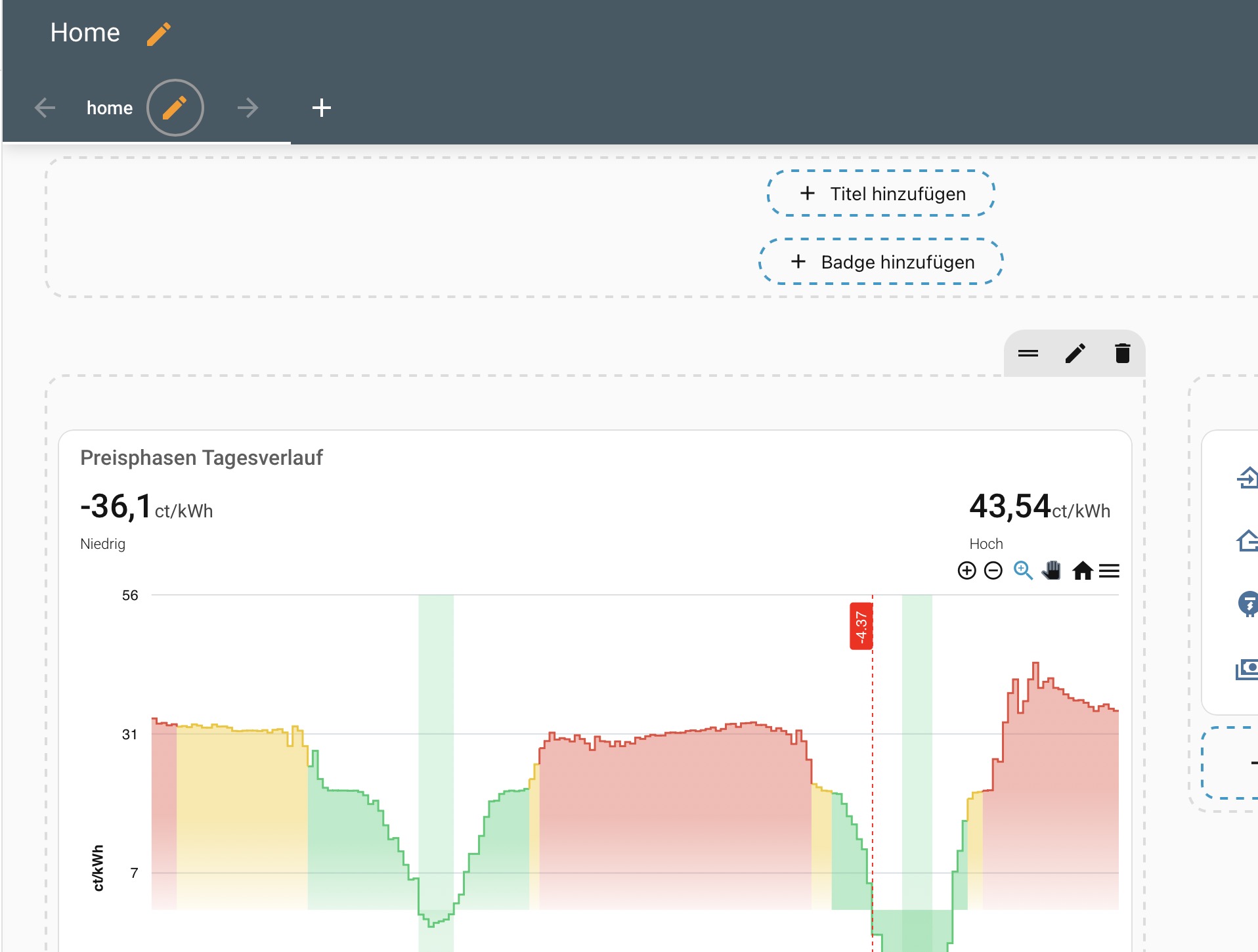

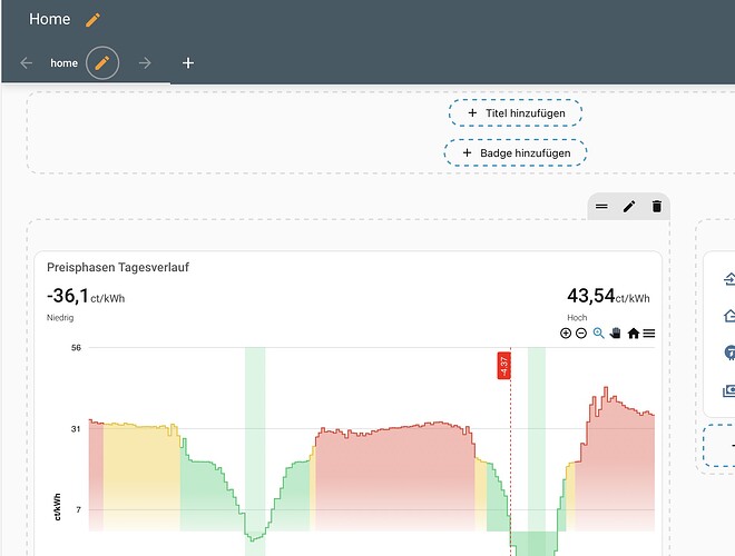

I am also having issues getting my chart full width, I have also tried editing the number of columns with no change, would you be able to check my code please (also a relative newbie at all this)?
@higgy_de and @clairec707 By all means paste your code.
I just added a new chart in sections view to double check my instructions
  1. Ensure you add the chart in a new section
  2. Click the edit pencil top right when hovering over the section. From there select how many sections wide it should be.
  1. Add the following code to your Apex chart.
  • grid_options: adjusts width.
  • height: adjust height. Make sure if you place this under apex_config: as shown. ensure the same indentation as below.
grid_options:
  columns: 48
  rows: auto
apex_config:
  chart:
    height: 150px
Thanks I’ll check this in the morning.
thats fixed it, many thanks :slight_smile:
I am pleased to hear.

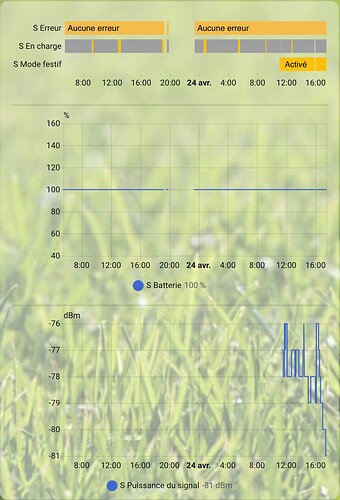

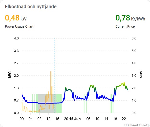

Hi there, first of all, thanks for good job … I was long for that kind of graph to show historical data on my mower on the “same graph”, superposing Data reported in both Percentage and “On / OFF” status :
what would be the best way (I assume this is possible) to show on top of the “Battery %” and “Signal dbm”, the “Error” (No Error or error present), “Charging” (Charging or Not Charging), and “Festive mode” (Festif or Not festif) on top of those % graphs ?
On top is it possible to show the label over time like “Online” or “Not Online” ?
P.S. on the card, I would like to keep this 3 levels On / OFF status bars on top of each other, is it possible - something like this :
Many thanks !!!

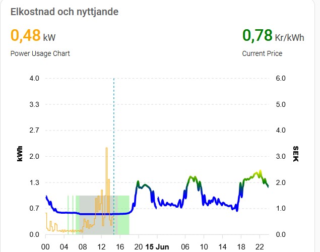

@higgy_de
If you are still interested.
A:
Just put this at the top of the yaml underneath the “type”:
grid_options:
  columns: full
B:
Instead of the text in the “Now” marker I put in the current price
first add a variable with your current price sensor (example is my sensor). at the top there are already some variables.
  v_price: states['sensor.dresden_aktueller_strompreis'].state
then in the “now” section put your variable into the label section, see example
 now:
    show: true
    color: "#ff0000"
    label: ${v_price}
at the end this should look like this:
Hope that helps…

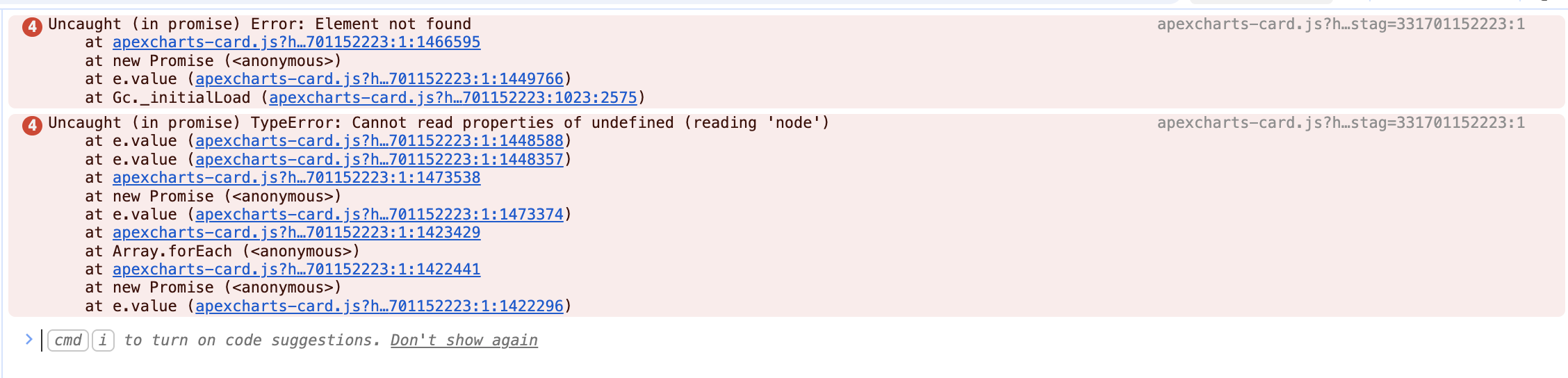

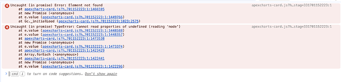

Hello
I augment the apex charts with a template config card. Sometimes the chart stops refreshing.
While it seems that the problem disappears once I remove the template config card, I cannot be sure if there is no coincidence and the real issue is on apex chart card.
At the end, it’s the apex chart that raises an unhandled error. Though I reported it also in config template card thread.
Can you advise any way to workaround or a way of debugging to find out why it is happening?
apexcharts-card.js?hacstag=331701152223:1 Uncaught (in promise) Error: Element not found
    at apexcharts-card.js?hacstag=331701152223:1:1466595
    at new Promise (<anonymous>)
    at e.value (apexcharts-card.js?hacstag=331701152223:1:1449766)
    at Gc._initialLoad (apexcharts-card.js?hacstag=331701152223:1023:2575)
apexcharts-card.js?hacstag=331701152223:1 Uncaught (in promise) TypeError: Cannot read properties of undefined (reading 'node')
    at e.value (apexcharts-card.js?hacstag=331701152223:1:1448588)
    at e.value (apexcharts-card.js?hacstag=331701152223:1:1448357)
    at apexcharts-card.js?hacstag=331701152223:1:1473538
    at e.value (apexcharts-card.js?hacstag=331701152223:1:1473374)
    at apexcharts-card.js?hacstag=331701152223:1:1423429
    at Array.forEach (<anonymous>)
    at apexcharts-card.js?hacstag=331701152223:1:1422441
    at e.value (apexcharts-card.js?hacstag=331701152223:1:1422296)

My implementation with an use of additional cards for more flexibility
For some reason header show incorrect sensor value.
The "now" line is in correct place. The "Today" value in header should be 0.04, but it is showing 0.01, which could possibly be value from one hour ahead.
If I remove data_generator it works correctly. Generated data is also correct.

I could technically resolve this, by hiding the generated value from header and adding new entity without data generation shown just in the header.
The header shows the most recently rendered value for this axis, even if it’s not the current one.
To fix this, add the entity as a separate axis used only for displaying the value in the header (disable it in the graph, legend, and tooltip). Also, make sure the generated series is hidden from the header.

I have a challenge, which I simply do not get how to solve...
I have a energy sensor, which has two lists of date/times in it self, looks like this for example:
list:
- start: '2026-06-14T07:15:00+02:00'
  end: '2026-06-14T14:45:00+02:00'
- start: '2026-06-14T15:00:00+02:00'
  end: '2026-06-14T15:30:00+02:00'
active_number_of_slots: 6
failsafe:
start: '22:00:00'
end: '23:30:00'
expiration: 2026-06-15T00:00:00+02:00
updated_at: 2026-06-13T20:49:02.961480+02:00
fetch_date: 2026-06-14
type: CheapestHoursBinarySensor
calendar: false
archived:
max_price: 0
min_price: -8.77
mean_price: -2.6446875
next:
list:
  - start: '2026-06-15T04:00:00+02:00'
    end: '2026-06-15T04:15:00+02:00'
  - start: '2026-06-15T05:00:00+02:00'
    end: '2026-06-15T05:15:00+02:00'
  - start: '2026-06-15T16:00:00+02:00'
    end: '2026-06-15T16:45:00+02:00'
  - start: '2026-06-15T17:00:00+02:00'

Now, in my Apex Card data_generation of this sensor I only get the first list - and not the second part. The second part is tomorrow, and it well should look like this:
However, what I get is this:
And here is the code I am trying to use:
type: custom:apexcharts-card
experimental:
  color_threshold: true
apex_config:
  legend:
    show: false
  xaxis:
    labels:
      datetimeFormatter:
        hour: HH
  tooltip:
    fixed:
      enabled: true
      position: topLeft
graph_span: 2d
show:
  last_updated: true
header:
  title: Elkostnad och nyttjande
  show: true
  show_states: true
  colorize_states: true
span:
  start: day
now:
  show: true
series:
  - entity: binary_sensor.test_billigaste_tid
    type: area
    curve: stepline
    yaxis_id: kWh
    opacity: 0.6
    stroke_width: 0
    color: lightgreen
    show:
      extremas: false
      in_header: false
    data_generator: |
      let data = [];
      let periods = entity.attributes.list || [];
      periods.forEach((p) => {
        let s = new Date(p.start).getTime();
        let e = new Date(p.end).getTime();
        data.push([s, 1]);    // jump up at start
        data.push([e, 1]);    // stay high until end
        data.push([e, 0]);    // drop straight down
      return data;
  - entity: binary_sensor.cheapest_hours
    type: area
    curve: stepline
    yaxis_id: kWh
    opacity: 0.9
    stroke_width: 0
    color: lightgray
    show:
      extremas: false
      in_header: false
    data_generator: |
      let data = [];
      return data;
  - entity: sensor.electricity_prices_today
    yaxis_id: SEK
    type: line
    show:
      extremas: false
      in_header: false
    float_precision: 3
    stroke_width: 3
    extend_to: false
    color: green
    color_threshold:
      - value: 1.5
        color: blue
      - value: 2
        color: green
      - value: 2.5
        color: yellow
      - value: 3
        color: orange
      - value: 3.5
        color: red
      - value: 4
        color: pink
      - value: 5
        color: "#ffffff"
    data_generator: |
      const data = entity.attributes.data.map((entry) => {
        // Center each 15-minute period correctly
        const start = new Date(entry.start).getTime();
        const end = new Date(entry.end).getTime();
        const midpoint = start + (end - start) / 2;
        return [midpoint, entry.value];
      return data;
  - entity: sensor.electricity_prices_tomorrow
    yaxis_id: SEK
    type: line
    show:
      extremas: false
      in_header: false
    float_precision: 3
    stroke_width: 3
    extend_to: false
    color: green
    color_threshold:
      - value: 1.5
        color: blue
      - value: 2
        color: green
      - value: 2.5
        color: yellow
      - value: 3
        color: orange
      - value: 3.5
        color: red
      - value: 4
        color: pink
      - value: 5
        color: "#ffffff"
    data_generator: |
      return data;
  - entity: sensor.shellypro3em_ece334eddd28_total_active_power
    yaxis_id: kWh
    name: Power Usage Chart
    color: orange
    opacity: 0.8
    float_precision: 2
    show:
      extremas: false
      in_header: true
    type: line
    curve: stepline
    stroke_width: 1
    extend_to: false
    unit: kW
    transform: return x /1000;
    group_by:
      func: avg
      duration: 15m
    yaxis_id: SEK
    float_precision: 3
    show:
      in_header: true
      in_chart: false
    unit: Kr/kWh
    color: green
yaxis:
  - id: SEK
    min: 0
    max: ~6
    opposite: true
    apex_config:
      tickAmount: 6
      forceNiceScale: true
      title:
        text: SEK
  - id: kWh
    min: 0
    max: ~4
    apex_config:
      tickAmount: 6
      title:
        text: kWh
So what I am after is how to do a data_generator that can handle the two list parts in the first sensor. The way I solved it in the how it should look, is by using a 2nd sensor - however that will only work today - tomorrow I am back at only one list since the 2nd sensor only has the last list part in it self. And I can not understand how to loop over two lists in this data_generator...?
