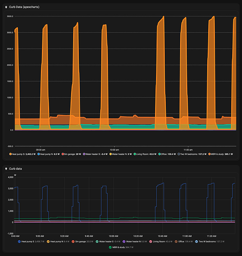

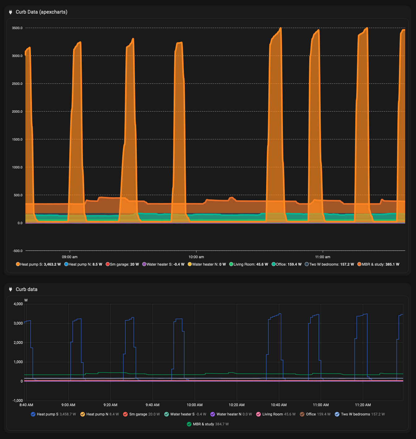

I've created charts in the history graph card and in apex charts-card, using the same series and the same timespan.
As you can see, the apexcharts graph is not stacked.
What am I missing?

try this:
apex_config:
chart:
stacked: true
