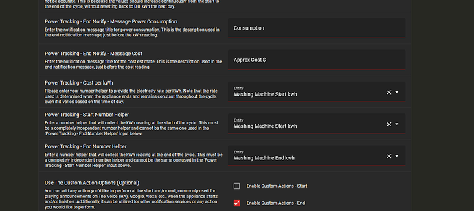

I just wanted to show and get verification if I did this correctly for the number part cost-wise. Is this correct?
No, you have the Start kWh helper in where the cost helper should be. Example here:
How do i show for cost or how do I set it up for cost?

You have to create 3 number helpers.
  1. For the cost of electricity - This can be used in multiple automation’s.
  2. For the start - Can only be used once for one automation.
  3. For the end - Can only be used once for one automation.
This link in in the FAQ and shows you how to do this. It also gives you a screen shot of my electricity number helper click here.
What you are doing is using the same number helper in ‘Power Tracking - Cost per kWh’ and ‘Power Tracking - Start Number Helper’. So please create another number helper for your electricity cost and input it into the ‘Power Tracking - Cost per kWh’ input. Below is the example as well.
