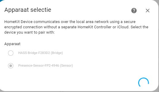

hi thanks for the response,
HA seems to see the device but when i click configure now it just keeps loading and in the end i get error message “error : config flow couldnt be loaded”
same when i try to add it using homekit device…
Knipsel
any ideas…thanks
